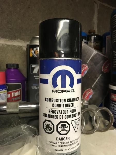

Ms Triss hasn't been running well for a while - in part I think because I haven't drivien enough. Was talking with my mechanic and he handed me a can of Mopar Combustian Chamber cleaner. He swears by it - and, particularly talked about working on K cars - he said he would get cars that couldn't hold and idle and were running crazy rough - he said a can of this and often he didn't even need to do any more. I can't believe the difference it made on the MG - it runs smoother and certainly seems more powerful - even SWMBO noticed that it sounded better.
It might be worth stepping back and just running some serious cleaner through it.
