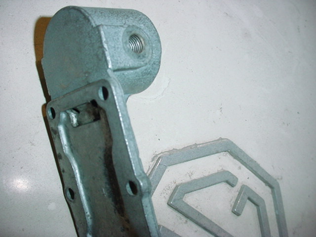

!/4 cup IS a lot. Yes, you need to leave room for air. Here's a pic of the cover for a Spridget front shock. Note the 2 small holes that feed into the main body of the shock. It takes a while for the viscous oil to find its way in, so unless you really pump oil in, you shouldn't overfill. The whole turret bit should be full of air. The oil gets quite hot in use, and needs a place to expand else it will expand out the shaft seal.
