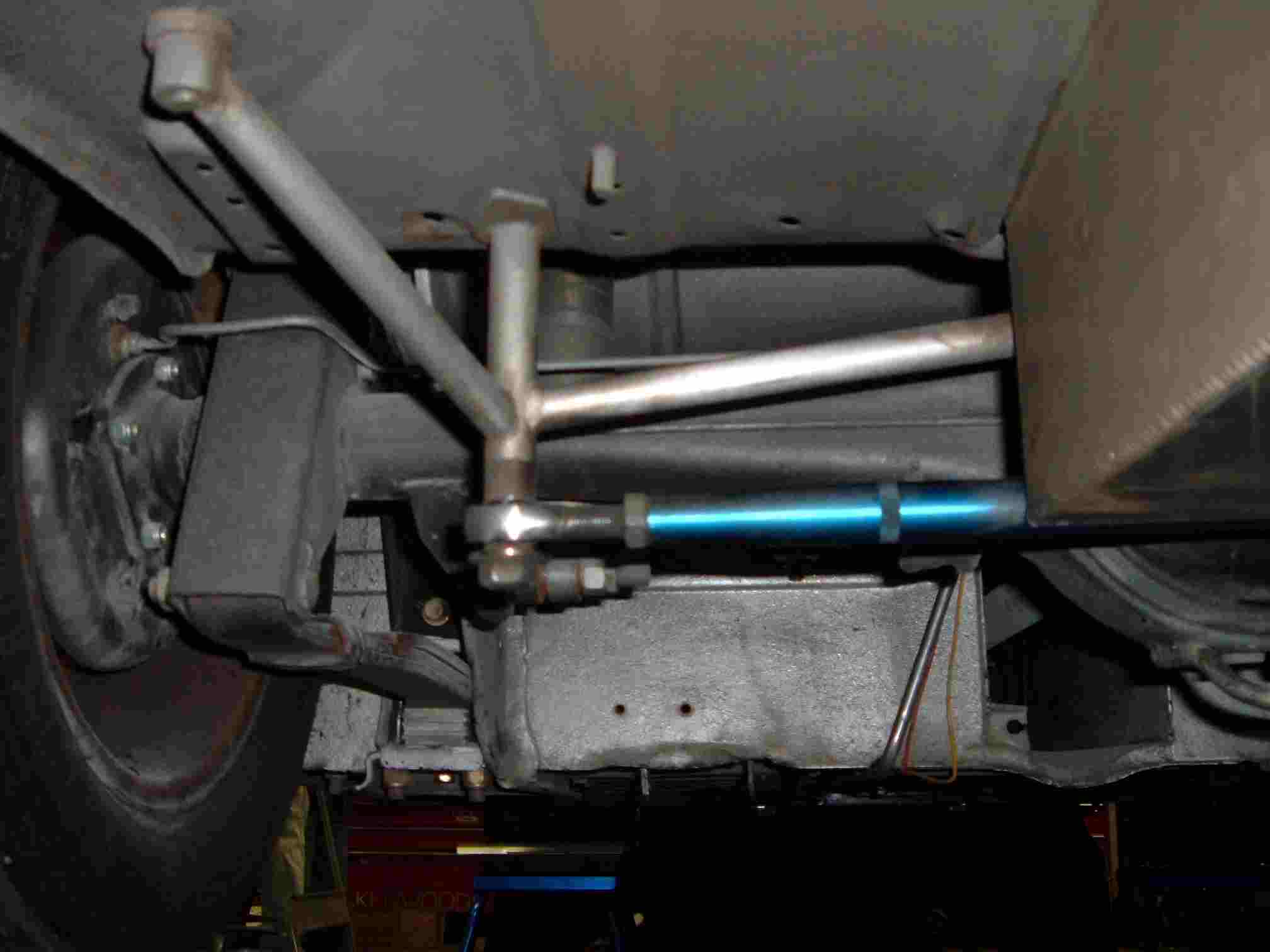

When I spoke with the guys at Speedwell Engineering about how to setup my rear suspension, the consensus was to remove a few leaves, shim the springs down and add a panhard bar. This stopped it from hopping, made the rear softer for more travel, lowered it and the panhard brought back just enough of the rigidy.
Really the nicest ride I have ever had in BE. But all of this is just IMHO and the advice Tom and his gang had given me. Attached is a pic for a guide.

The Panhard bar is for de-stressing the spring mounts as much as it is for location of the axle. Technically the springs have a hard time deflecting horizontally, but then they want to twist insted. The bar puts a large portion of that force into the chassis mounting point.
Wow, Pat. Looks like you removed more than just a few leaves.

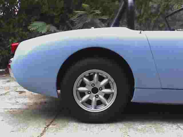

The car in the picture is setup for the track. For the street, I have 1/4 shimmed, a wedge on the passenger side (so that it is a lil lower then the drivers, balances out when I am in it). Three leaves are removed, I can't recall which ones and the panhard. See attached for outside pic.
