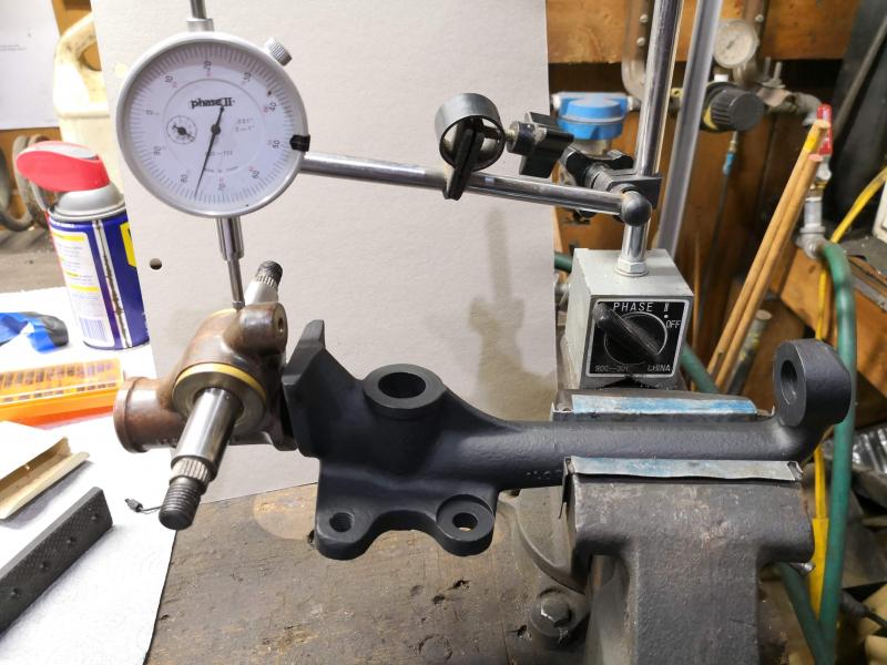

Just wondering what you guys think about this vertical link.

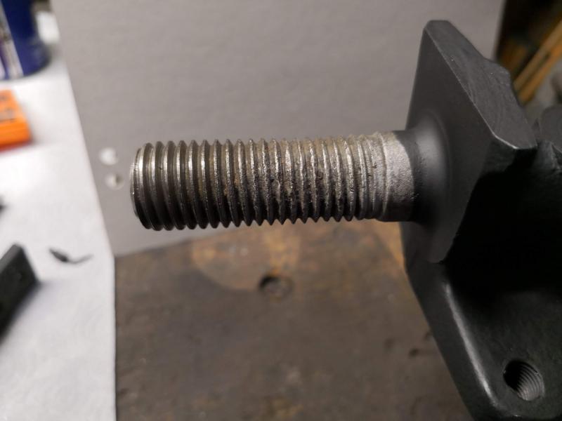

About half the threads are somewhat deteriorated. Maybe it rusted under the care of a PO?
With the threads fully engaged I can wiggle the trunnion .010 in using the setup in the photo. But it seems like when held by the ball joint there is little or no opportunity for the link to move in this direction? I'm not seeing any noticeable play in any other direction.
I also checked the run-out of the upper bore (for the ball joint) with the threads chucked in the lathe and got around .050 in.

Personally, I would replace assembly, new if possible, good used if not. I like non-corrosion, especially the way I drive.

Looking at that, yes, some rust, but I sure have seen wear (like lots of driving and no lube jobs) on the steel threaded bits.
Junk.
Replace.

+1 on replace. There's lots of margin, it will probably be fine if you don't go jumping other cars or whatever, but not worth taking a chance IMO.
M_Pied_Lourd
+3 replace.

I don't know if these are as prone to snapping off the way they are on neglected Heralds, Spitfires, etc., but having experienced a snapped trunnion on a Spitfire while in motion, I'm +4 on replacing!

I would expect the rust-roughned threads to wear down the brass trunion every time you made a turn. Should be some good used out there; early TR4s used the straight v-link as well. Jeff
Oddly enough, the trunnion looks fine. About half the threads on the link are good, while the ones in the bad area are visibly eaten away from their full thread profile. I suspect the good threads are holding everything in place well enough that the bad threads are not even touching the trunnion.

Hmmm - Interesting observation and your explanation does seem logical. Since they weren't touching, moisture could get in there to rust the v-link.
I've been careful about keeping it lubed and there was no red rust on it when I took it out. Looks like somebody in the past cleaned it up and stuck it back in.
