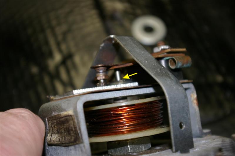

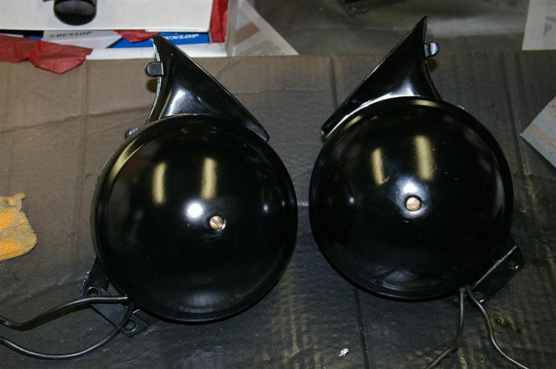

Dan, I can't recommend a rebuild service, but it is something you could tackle yourself if so inclined. I cleaned and painted mine. The key it to add a drop of oil as shown below. One horn would just not work and was drawing lots of extra current. Drop of 3 in 1 oil sorted it out and its been fine for 4 years now. This article may also be helpful (https://www.vintagemg.com/articlepdfs/thorns1-2.pdf).

This is the rod that Mike was referring to, and even the manual tells you to routinely put a drop of oil on it. When the coil energizes, it pulls the diaphram upward. As the diaphram pulls up, it pushes this rod up with it.
The rod hits this contactor, which then breaks the circuit that was energizing the coil. Once broken, the diaphram springs back, the rod drops, and the contact contacts again...so the process starts all over.
