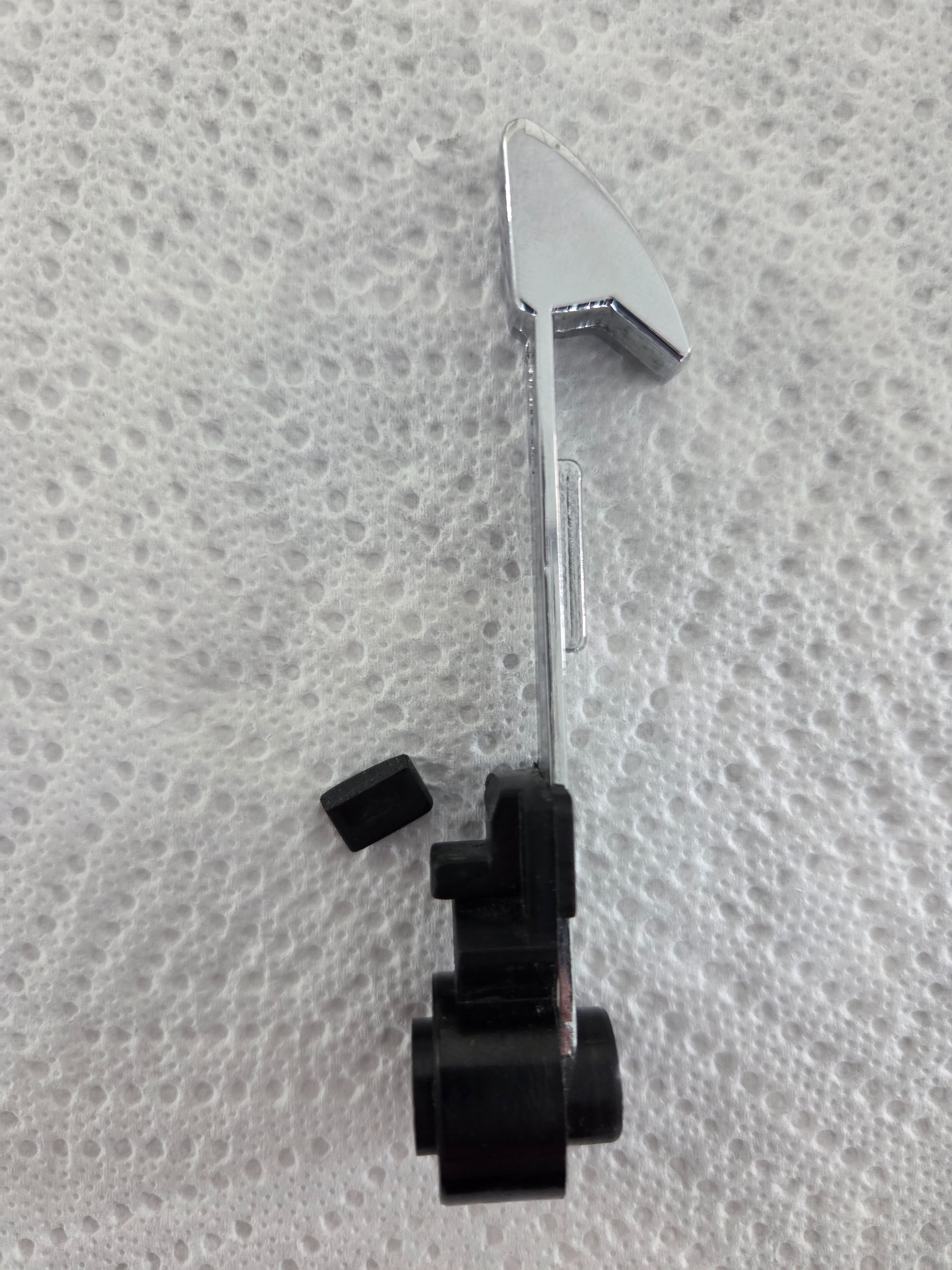

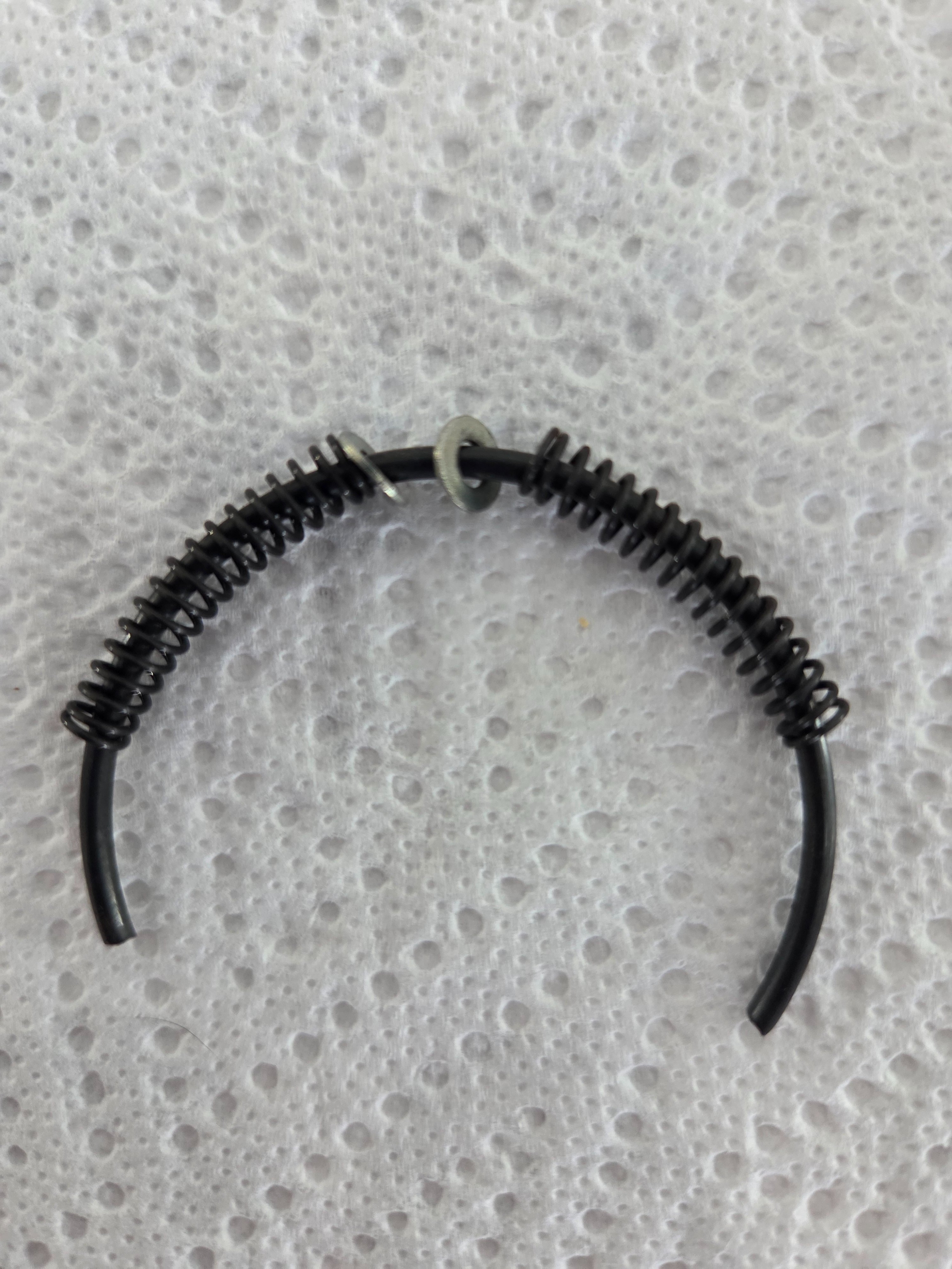

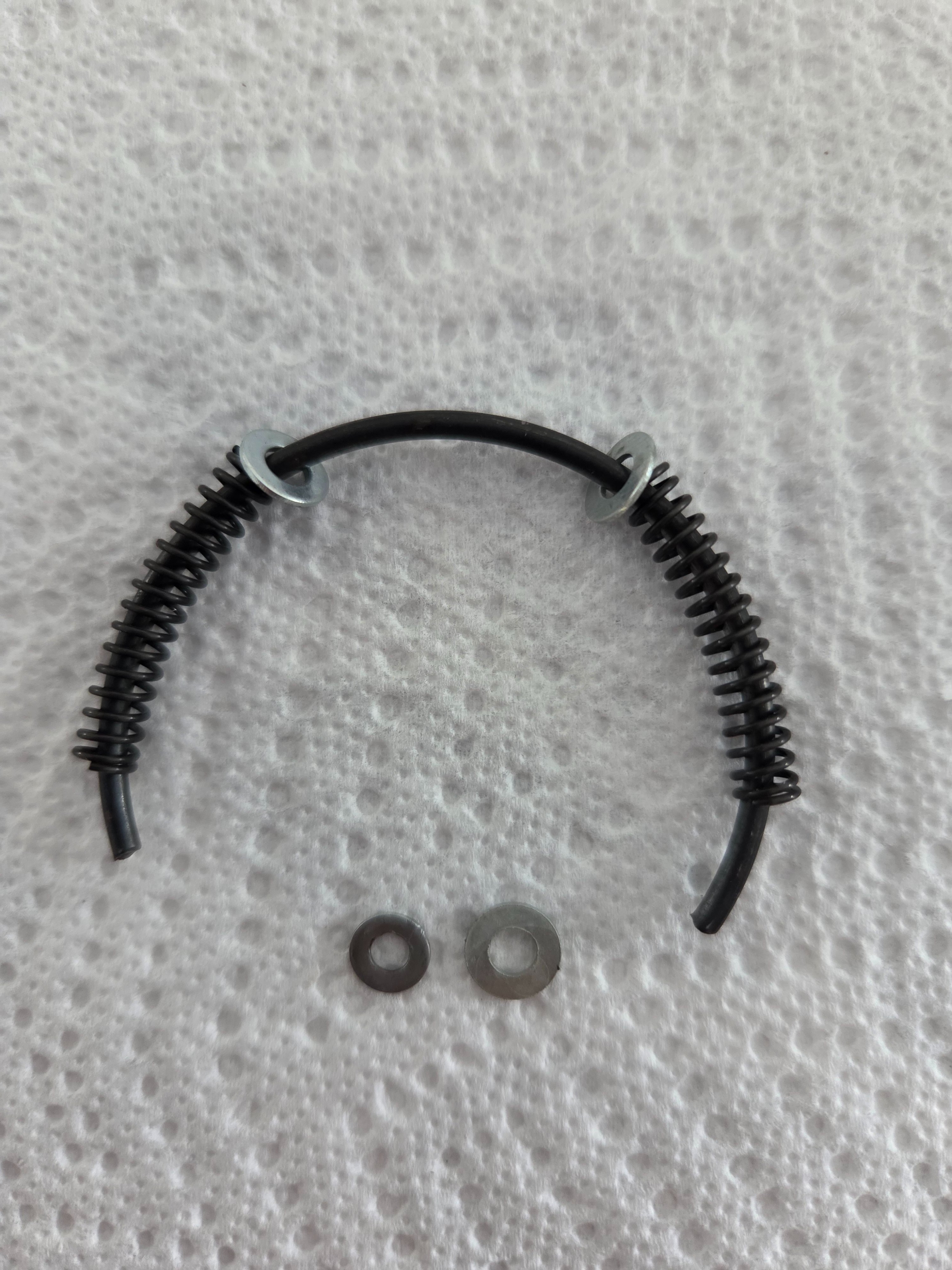

Incidentally, I'm not sure how many have the misfortune of needing to take apart their trafficator, but if you have an aftermarket version (mine's from Moss) then you may want to swop out the 2mm washers on the springs of the trafficator arm for 3mm washers instead as I've found that these little washers can get under the lip and crack it (photos attached).
