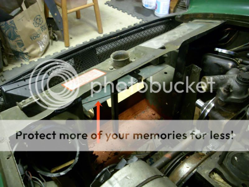

hood [bonnet] release broken cable

Here is a shot from a different angle -hope it helps:
This is from a 1975 Midget, by the way.

Now that the latch has been sprung, what is the easiest method to repair it? I won't be doing it but I'm trying to give the new owner an idea of what he will have to do.
Route cable under latch hole, gain some slack by loosening elsewhere, pull cable up through hole, attach to latch, tuck back under, bolt latch back on, pull cable taut and refasten where ever it had been loosened.
or remove upper shroud. (no idea how much work is involved in that).
Naaa, just tell him the installs procedure is, ready for this, ??
The reverse of the removal, lol.

I ALWAYS run an emergency bonnet cable on all square body Spridgets.
A length of wire hooked around the bonnet latch lever and run it to the inner left fender with a large washer on it.
Now even when you want to work on the car, just reach under the fender and tug the wire.
I still keep the interior bonnet cable but having had more than one break at the most inconvenient time, the extra external cable is piece of mind. And more convenient. A simple wire (copper or something that will not rust) and a loop or washer on the end. A wire tie to hold it up inside the fender and it's done.
