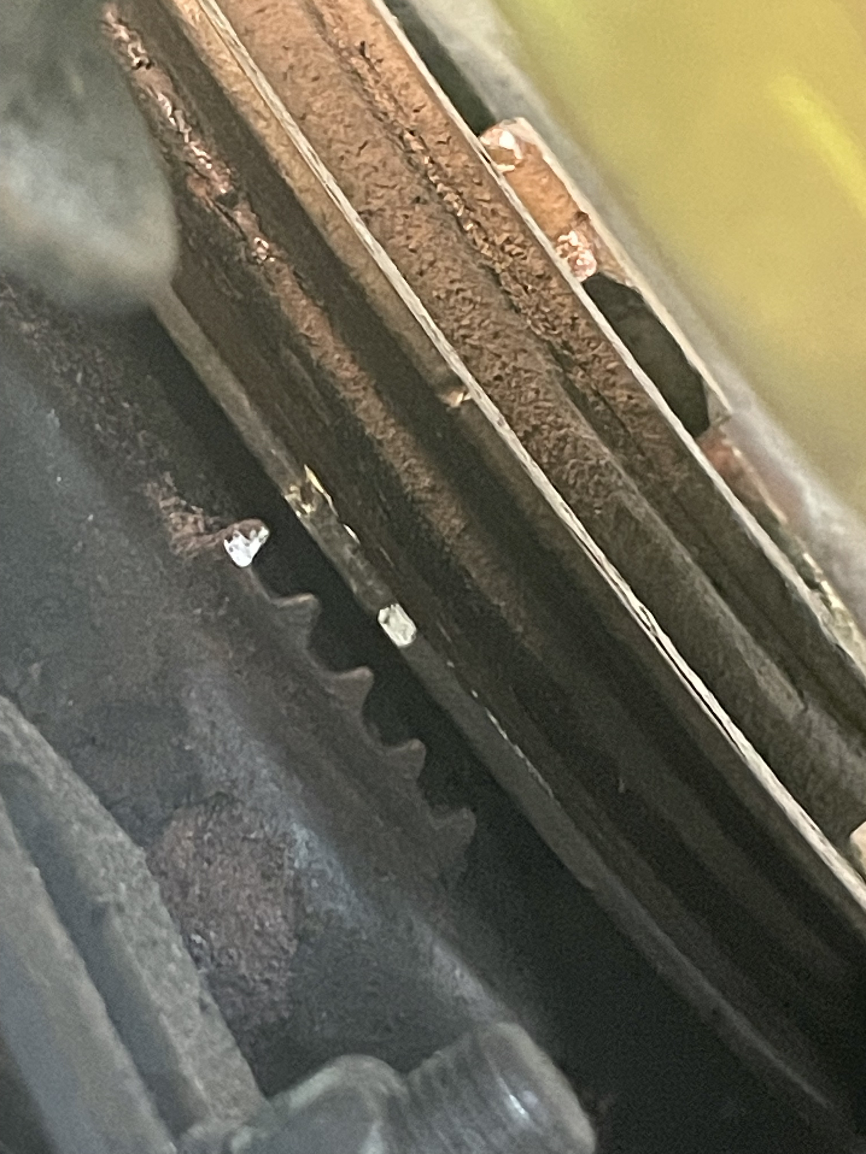

I have a question regarding my MGB form 1975. The engine won't go down in rpm while idling and I have backed out of the idle screw. I could come up with two theories for this.
The first one is that the timing might be wrong. I have set the timing myself with a strobe light but I am not sure I have done it right. When I set the timing I lined up the indent in the flywheel (Check the picture) with the TDC mark.
Then I marked the TCD and about 10 degrees BTDC on the flywheel. Then I used the timing light to line up the marks (with advanced timing removed). I have got some backfiring as well and that's a symptom of bad timing.

It is unlikely to be timing. Even if not perfect, it is good enough.
It is relatively easy to test for air leaks with the engine running, spray starter fluid or WD40 around the intake manifold and where the carb connects to the manifold, if the idle speed changed you have an air leak.
That said, I wonder if you have an issue with choke or butterfly valve? What carb do you have on the car? By 1975 MGs had a lot of funky emissions stuff. Does it have a manual choke? If it is stuck on (or partially on) that can make a high idle.
