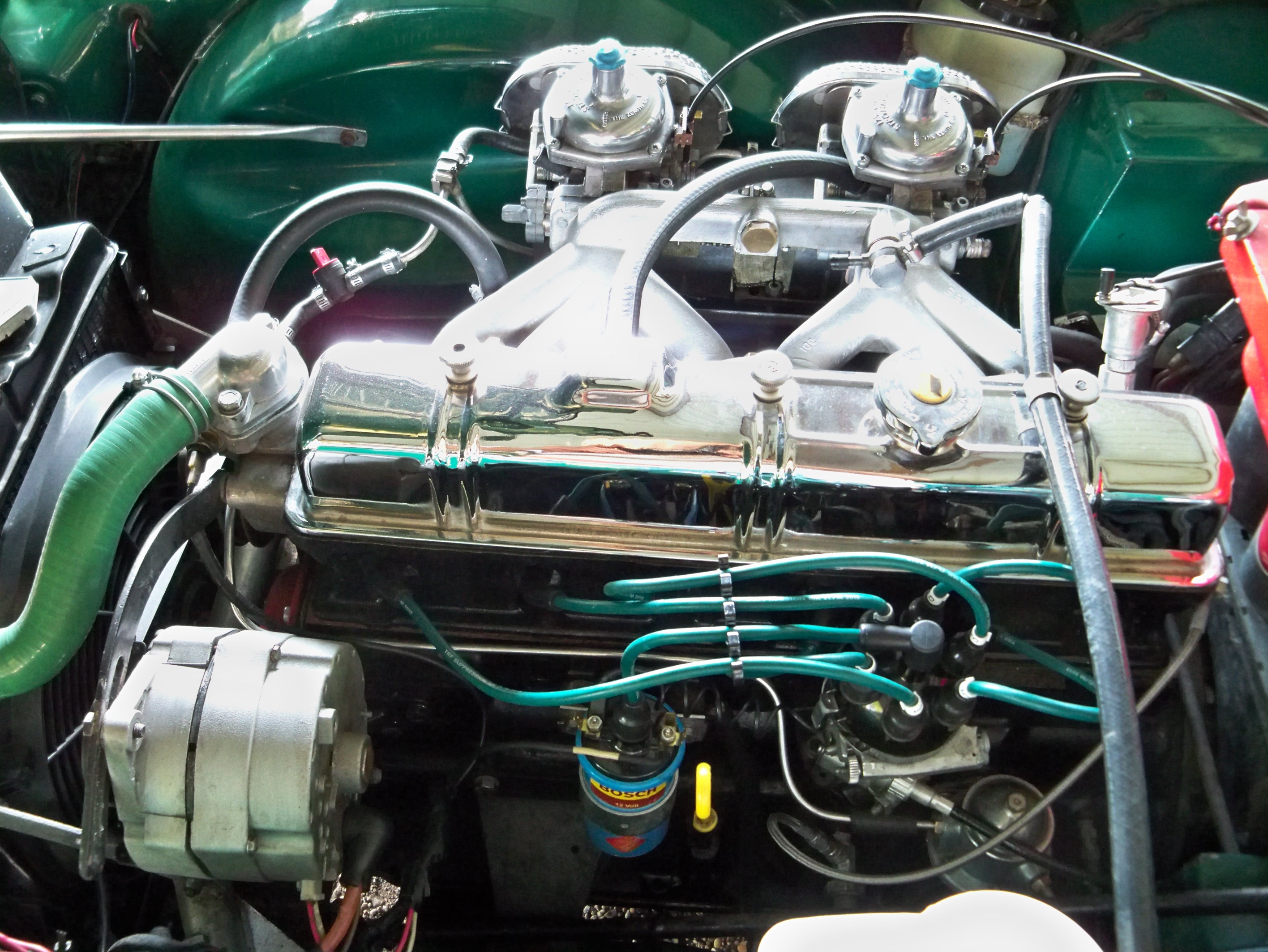

Ok, new one on me. But, Pertronix Flame Thrower coil installed.
Those are known to leak. Happened to 2 of mine and to a Forum friend as well.
Feel around the bottom of the coil for oil...There are epoxy filled coils...the Bosch Blue for instance.
You stated you installed a, "New cap, new rotor, new Petronix coil". I do not know if the iner modual could cause your problem, but I would still replace the new electronic stuff and go back to original until I figured it out.
