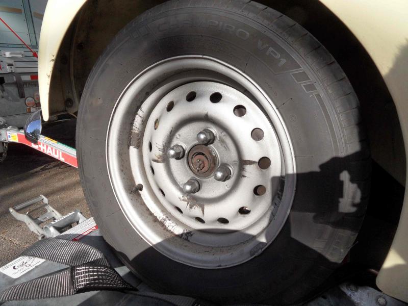

We are spending the night at a super 8 in Loveland outside Memphis. The tr is at the previous exit. I thought the rear brake shoe was rubbing in the inside of the drum and we were stopping every half hour when I realized the squeak was coming from the front wheel. The bearing disintegrated except for the inner part that is stuck on the stub axle. I tried hammering but it will not budge. Tomorrow we will try to get a puller and bearing and move forward. What a bummer. If anyone is close enough to help call my cell at 281 732 6188.

Here's a few pics. My oldest brother standing by a hill -close to my cousins house in Summerhill. My 93 year young Mother in front of her house in Pa -she didn't want to ride in my TR until she heard the top was down. It reminded her of when she rode in a motorcycle side car, way back when she was dating my father -something she never let my father find out about. Hopeless is self explanatory. I am stunned that all that was holding the wheel on, was the edge of the D washer riding against the inner edge of the hub just outside the race. I think this picture is closer than I ever want to be to a wheel falling off. To think I was driving 75mph seconds earlier...
