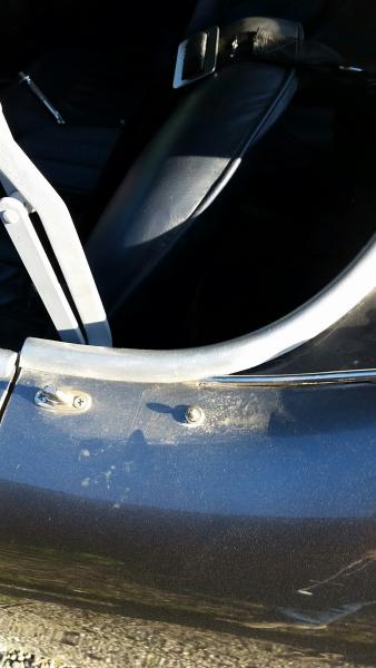

I'm sure you guys will find this outrageous, but i found them to be so contrary and so ill advised in that they will do nothing but help to induce trapping water and crud and causing corrosion that at the last minute I decided not to put them back in. i have to admit that it was an after thought and if I would have planned it from the start I would have finished my edges to the shrouds and fenders a little better. But the dang things are just bling intended to dazzle the uninitiated. Real Sports Cars Don't Need Them. :)
... the dang things are just bling intended to dazzle the uninitiated. Real Sports Cars Don't Need Them. :)
I've always assumed they were to hide gaps between the shroud and wings. If your edges have no gaps you are either the best panel beater on the planet or extremely lucky.
