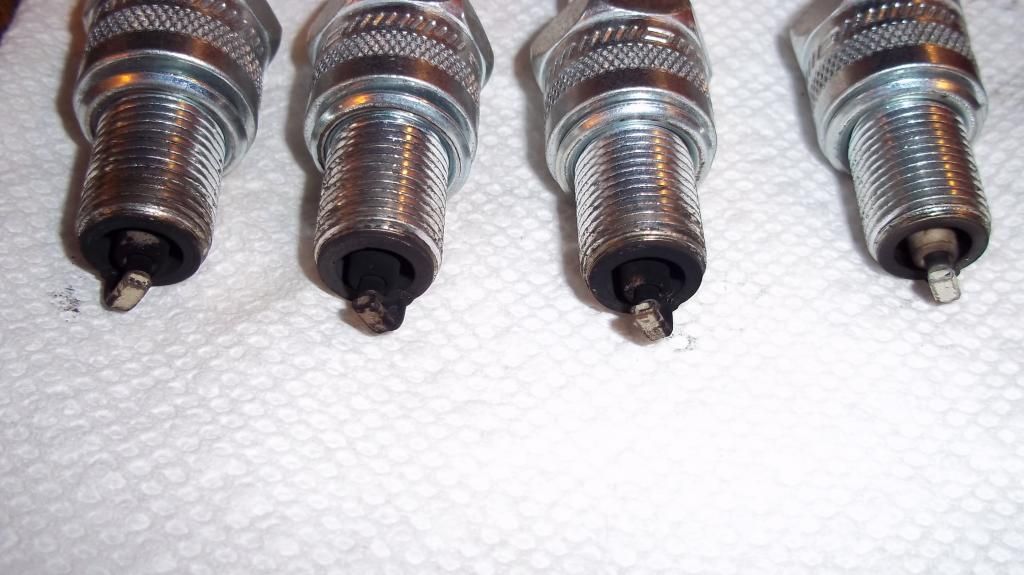

I just took it for a run of about 2.5 miles with brand new plugs and I'll post the photo of them that I just took!! I have oil in dashpots but haven't torn the carbs apart. I did take the covers off the float bowls and the fuel,etc. looks clean in there. How far would I have to tear down the carbs to find out anything?

Gary, those plugs are too rich, I suspect they are clogging causing the misfire. See this article:
Reading spark plugs
Here is our previous conversation (when you came on board) - I think it is the same thing. Lean out your carbs - start with two flats and see what happens. adjust carb mixture

In terms of blockage, I would simply start by taking the top of the float bowls and checking for crud, but, those plugs are nasty - do the mixture first.
Thanks JP...that's my plan in the morning. Don't know why it went from a nice tan plug to nasty black unless it was the fuel filter change. Now it has fuel!!!

I put the old rotor back in, took off the dashpots and ran the valve seat up even with the bridge, adjusted toward rich 1 1/2 full turns, made sure dashpots had oil...car would barely fire and wouldn't run. Adjusted both toward rich a little at a time until it started and idled with 2 full turns + 2 flats. Drove and still got backfires from rear carb. Pulled the plugs and #1 & #4 look good, #2 & #3 are black. How can this be??? Checked compression yeasterday and it shows #1 175psi, #2 185psi, #3 180psi, #4 180psi. Seems high but all close to the same. Still stumped...:(
