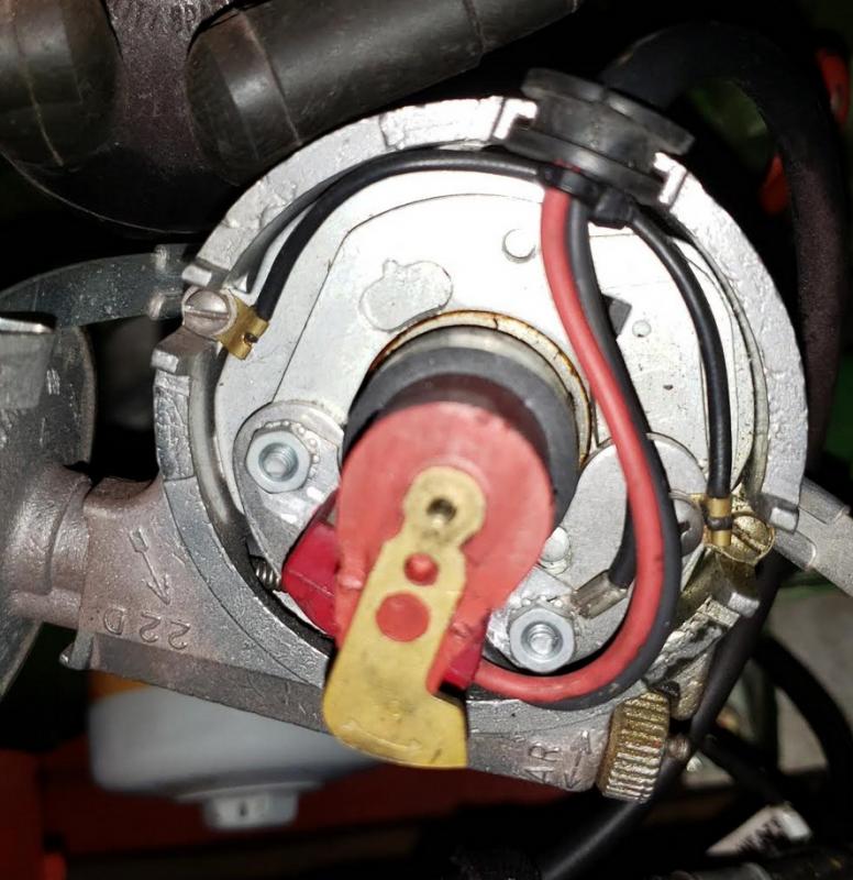

steveg
I've been running a Jag 22D6 on my Healey for a couple of years - bought it at a yard sale and had Jeff Schlemmer overhaul it and curve it for the Healey*. I wanted a top-entry cap to run a Pertronix II which requires modern resistance wires. Top-entry caps not available for the stock older-Healey DM6.
I read online some British racers traced Pertronix problems to unreliable grounding through the various joints in the distributor, so I ran a separate ground wire from the base plate of the Pertronix unit to the car chassis.
Pertronix II has built-in protection against frying thru leaving the ignition key on.
FWIW, am running points in my TR6.
* I removed Jeff's points in favor of the Pertronix.
