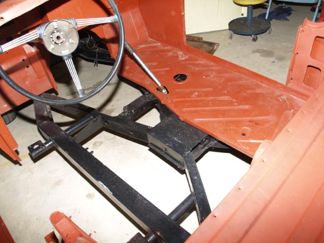

I've been avoiding it. Let's face it, I am still a novice at this. I've learned so much in the past few months, but every time I start to get on the tub, I find something else to do. I've run out of things to do (unless I move forward).
So here it is: One sill, A and B pillars, and floor on Driver's side are not connected. No pads or spacers installed and until Sunday, nothing was bolted down. The passenger side floor pan has not bolt holes (wasn't filled with fiberglass at least) and it looks like the rear mounts are sort of missing.
the PO at least purchased the brackets but didn't install them
So here I am, with the tub laying on the frame (front bolted down in six points) and can't figure out how to move forward. I've been advised to brace the frame before I pick the tub up, but I can't pick up the tub until I get the sill squared away. I can't get the mounts welded in without picking up the body (or maybe I can?). I'm in the dark here, and though I love my dad (owner of a 61) he has no clue either..
Two thoughts: We break the welds holding the rearward floor and B pillar, then pick up the rear part of the tub, or spot weld (in a few places) what I have, brace the body 9 ways to Sunday, then pick the whole thing up, and worry about alignment of the tub later.
I'm might make the shout-out and invite anyone who is interested to come on by for some cold ones and grub, with use of tools and compressor (and most likely the lift) included (once we get the tub squared). If anyone is interested in hanging out and supervising, give me a shout.

Unfortunately, the PO did not put any pads or shims in place that I could see. In fact, all the original pads and shims were in a baggie marked as such along with all new pads and shims.
I thought I might go on with bolting the front down without pads (sills and pillars and floor pan are already welded) working towards the back. The first time I put the inner sill in, bolted it down and rested the body (front) on it, it started to twist the sill. Bolting it down up front took some of the weight off and the sills didn't twist. I did put the firewall shims in though (for support).
Can you tell from the first pic if most of the bracket is there? Repair part (second pic) has sides and a bottom. There are sides on the tub but no bottom (where it bolts to the frame). Eventually I will need to address it, so will that whole piece get welded in, or just the bottom of it (cut off). The PO had a plan (that doesn't match what is the correct way) and I can't figure out what it was.
I put the doors on the front and the gaps and lines are pretty close and they open and close without forcing. Drivers could be a little closer at the latch (about an eighth of an inch wide currently) with the back still floating. If I put the pads in on the Driver's side, I'll have to go under the tub on the passenger side and put spacers there too. The frame strips might have to wait until the tub comes off, after the sills are welded to the pillars.
You see my confusion. I'll take two steps forward just to take three steps back. Granted, when I take the two steps forward again, they'll be much easier. I'm actually frightened of welding the sills to the A and B pillars. Which is which by the way. I always thought that the A pillar was the front, and the B was the back.

So you have one side with an inner sill in place sitting on the frame and no inner sill on the other side? What is the side without the sill sitting on? Does one side have a new floor?
Currently it is sitting on a bolted down sill.
Before it looked like this
PO or someone dropped the tub back on the frame after DS sill, floor and both rockers were removed. Rear mounts are both partially cut away. New floor pan and rockers and new sill were in the back seat. Prop shaft tunnel was non existent but Frank Canale made me a new one.
I wanted to pick up the whole tub to get all my spacers in place but was afraid of too much flex. I've been putting it off since I wasn't confident in my next step.
Though I cant see it, I'm pretty sure there aren't any spacers currently installed. All of the old ones are sitting in a bag, and all of the new ones are in bags on my bench.
How could there be any shims in place because the shims go between the inner sill and the outrigger of the frame. What do the out riggers of the frame look like? The other shims on the back and front are not as critical as the center and can go in later. The inner sill is a straight edge for the tub to sit on and the back and front of the car will follow that line once the sill is installed. Do you have a welder? If you do not, you can screw the inner sill in place at the lip of front kick panel along the top to hold it and at the area behind the B post on the bottom to hold it while you get the door opening correct. Do you have pictures of the body area behind the B post?
Sorry, I did look up at the above post and see the picture that shows the floor and sill are in on the passenger side. Seems to me you need to be the other sill in. Those shims are meant to be moved around. The manual suggest 4 shims on each outrigger, but you arrange them by how many needed; they help you adjust the tub a little. You need to lift the tub up about 2 inches and look on the out rigger and see if there are any shims or you should be able to just jack the whole car up and look.
The problem was the PO put no shims on the other side, or bolts or anything. I have the sill and floor, but can't really put them in unless the other side is bolted down and shimmed.
So to recap: Tub minus DS sill and floor and no rear mounts, dropped on chassis and nothing bolted down and not welded at the A and B pillars on the DS.
I just want to make sure that I do the best that I can the first time and have to redo the stuff the least. The tub will be coming back off the frame eventually so that I can paint underneath.
You can lift the tub up with small jack and put 4 shims in on each out rigger--- no big deal; you are going to moving shims around until you get the doors correct anyway, maybe 5 here and 3 there. IMHO you do not want it bolted tight anyway; maybe some wire so it does not slide off when you lift the driver side up. Put some wire through the holes and leave the tub a little those so you have some give and lift the driver side up and either put some lumber on the frame or on jack stands or some cribbing and try a fit the sill. That is where you are stuck.

Just for planning...2 strong men can lift the tub in your current condition. Or 4 weak men very easily! I would not try to lift it alone or with a hoist in its current condition, as it will flex too much and could permanently bend it. That's not fatal, but will leave one more thing to fix!?!
Realize that placing the tub on the frame was simply the PO's way of consolidating the project for sale. It has nothing to do with his restoration effort. I personally would pull it off before doing anything...to look all over and, of course, install the pads before you start working.
I recommend using the factory recommended number of pads while doing a frame off like yours. Later down the road, you can alter the number to fix issues that pop up. But best to start "neutral" as you work.
And that was my big concern, flexing the tub.
By the way, are there 4 spots in the rear (aft of the floor, including the rearmost) mounting points? I saw a kit in the TRF catalog but can't find one in my stuff. I want to make sure i get all the right spacers in place before I try to align the pillars for welding.
Aft of the floor there are the 2 mounts, which you have in the picture above, which use pads. Then, the bumperettes have a single, very long bolt each, which passes through the holes in the rear apron and bolt to the frame with no pads.
Oh...I know it sounds counterintuitive, but it is best to have ALL the mounts at least snug (with the exception of the front and rear bumper mounts) before installing any new body parts. Just a fraction of a degree for the rear apron to lift will be enough to throw off your rear door gaps. Same for the front if you don't have those installed.
By now I think you're getting the importance of having everything mounted as it will be in the final car before final welding anything...tacking is OK, but save the final for a fully installed tub.
