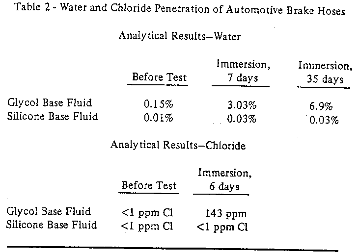

Er, I think you've got that backwards. Non-hygroscopic means it DOESN'T absorb water from the environment (including salt right through the soft lines), become corrosive, lose its boiling point, etc. DOT 5 is suitable for service for 10 years or more, while the glycol-based fluids (including 5.1) should be changed every few years, because they are hygroscopic.

No, I meant what I wrote: DOT5 rejects water which accumulates in the lower recesses of the circuit and causes rust. So even if the silicone is still perfectly good, you have to purge the system to remove the water.
That's a new one for me. I've heard of residual DOT 4 fluid lingering in the system after a changeover, and experienced problems with corrosion because the stuff is essentally sequestered by the silicone, but I've not heard of that on a new/clean system. But I don't drive in the rain, either.
