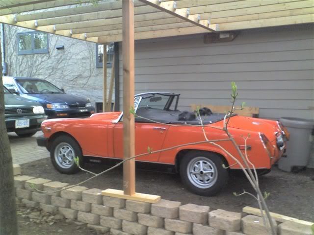

Well, the carport isn't done yet (as you can see from the picture) but I couldn't wait any longer, so I've started the disassembly for the DGV conversion.
