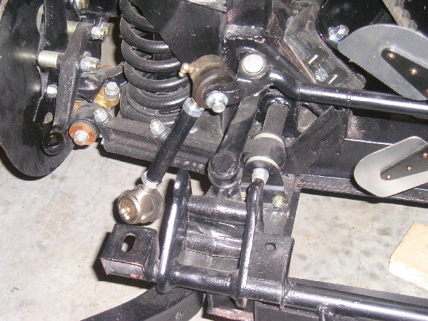

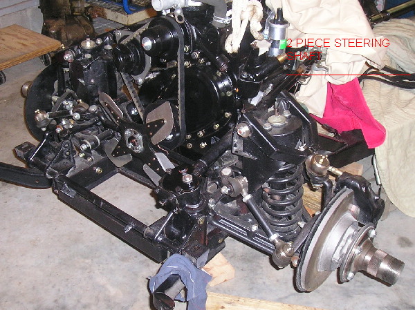

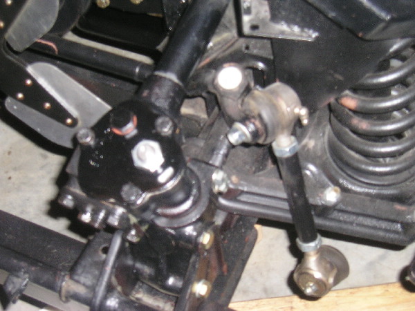

Randall - I tried the next spline over but it was still tight because now it was too far the other way.
Interesting. So the replacement joints have the splines clocked differently.<div class="ubbcode-block"><div class="ubbcode-header">Quote:] So I tried to center it as best I could [/QUOTE]Certainly the right way to do it, put the ball joint level and hold there while you tighten the nut. Come to think of it, that's probably what I did without ever noticing if the splines matched or not. But I only changed those joints once in over 200,000 miles, they don't seem to wear much since there is so little force on them. And the boots can be replaced separately.
