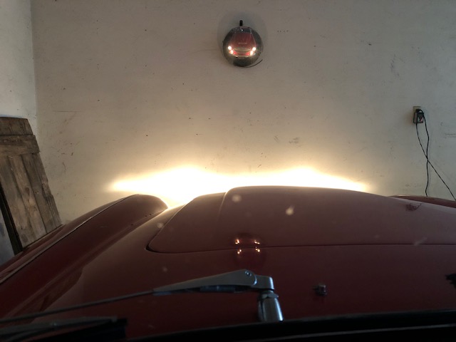

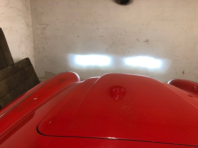

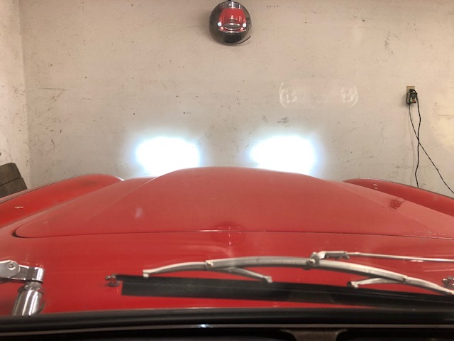

I replaced my BJ8's incandescent headlights with LEDs. First pic is incandescent--AFAIK aftermarket--and the next two were with the LEDs (low beam then high). Note these were complete units, not just bulbs and I suspect the reflector bowls--likely parabolic--have something to do with the beam. The only thing I don't like is the glass fronts are flatter than the incandescents, and don't quite look right on a voluptuous Big Healey.

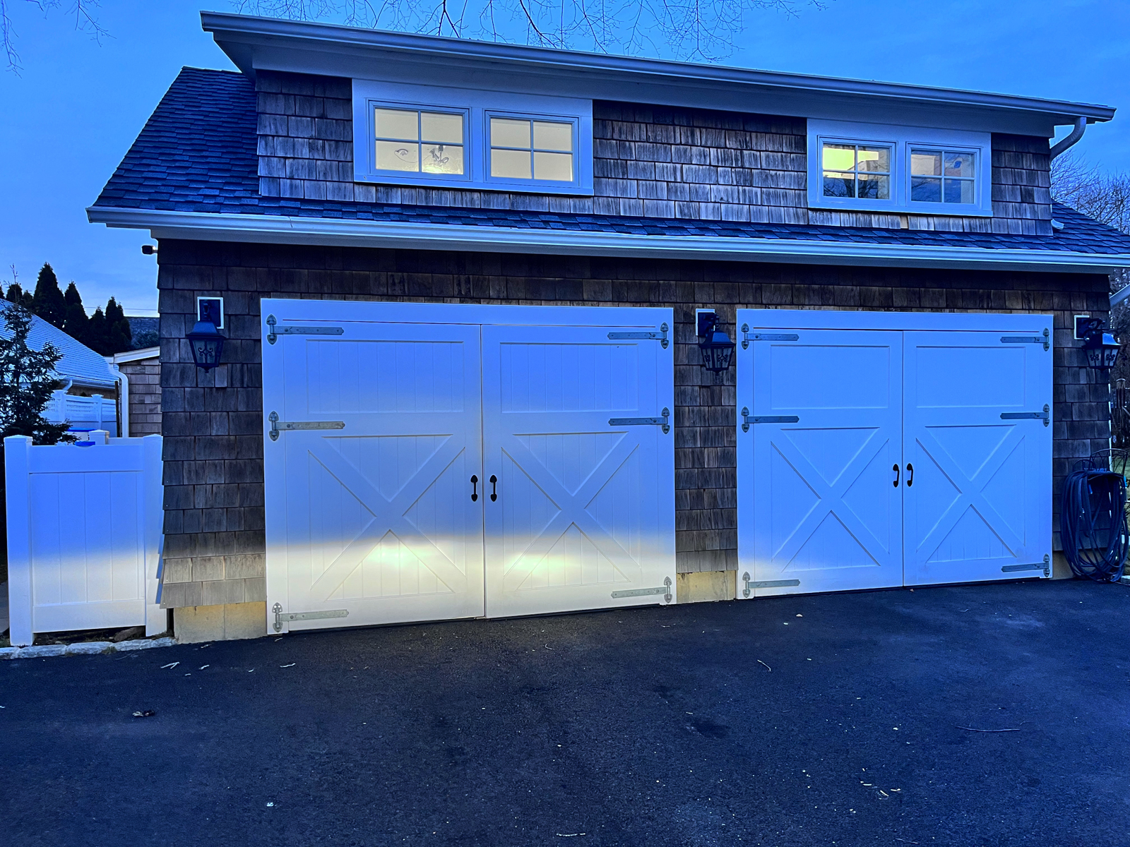

Where I mostly drive the car, we have deer in the heart of the village and on unlighted secondary roads and even visiting my own back yard. While I rarely take the Healey out at night, I was astounded by the effective visibility increase when I swapped out the sealed beams for the new LEDs.
This shot was taken the evening I installed them and before final adjustment. Vehicle is 25 feet back from the doors.
