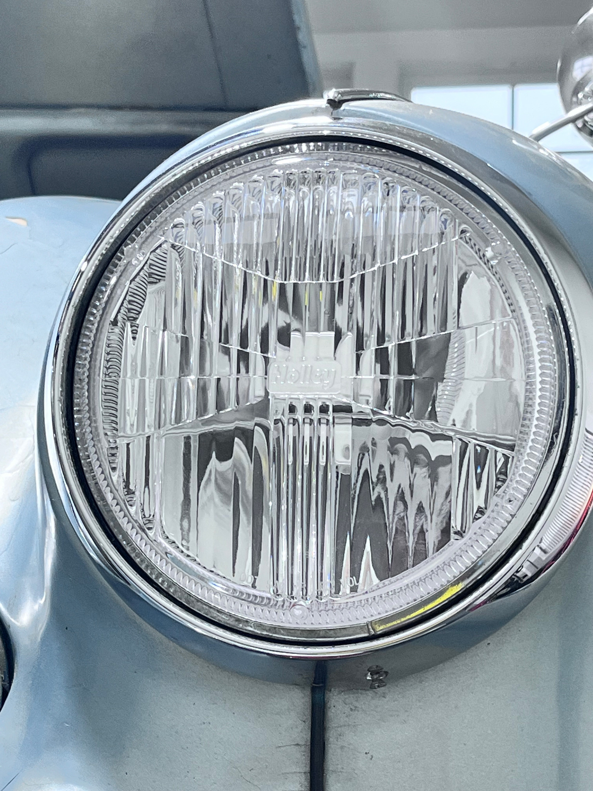

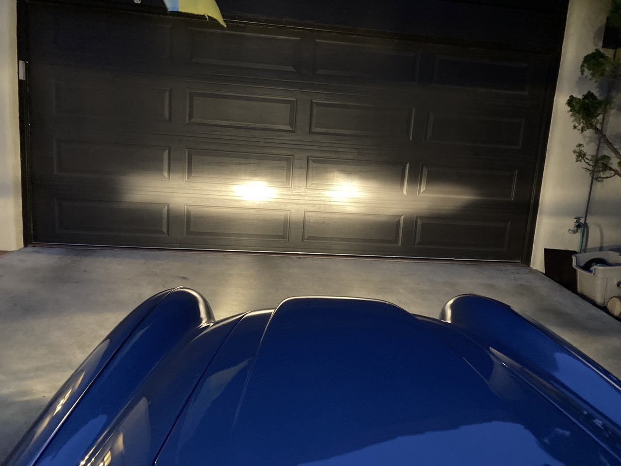

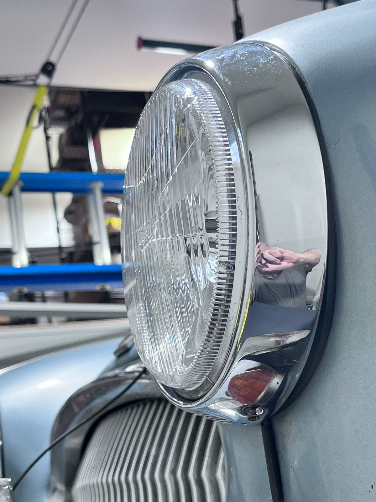

I have two problems with the Holley Retrobright headlights:
1). The lens pattern does not look like the original Lucas pattern.
2). They are emblazoned with ‘Holley’ on the lens.
The retrofit LED units I linked to in my original reply (#2) are complete units with reflectors, look similar to the original equipment headlights and are marked Lucas on the lens and hopefully will provide a noticeable improvement in lighting output and brightness along with the advantages of less heat and lower power consumption. Since I already run hyperbrite LED bulbs for my parking lights, turn signals and brake lights these Classic Performance supplied units therefore meet my specific criteria and may do the same for others wishing to retain an original appearance….
Guido, JoeCA, et al.
Had I been aware of the existence of other matched pairs of vintage-look LEDs with reflector assemblies, I may have given them precedence over the RetroBrights which look especially good on a Chevy or a Ford. ;)
I appreciate your point of view, Guido.

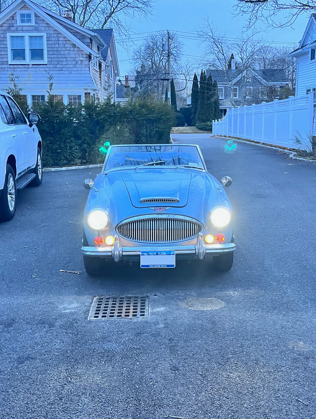

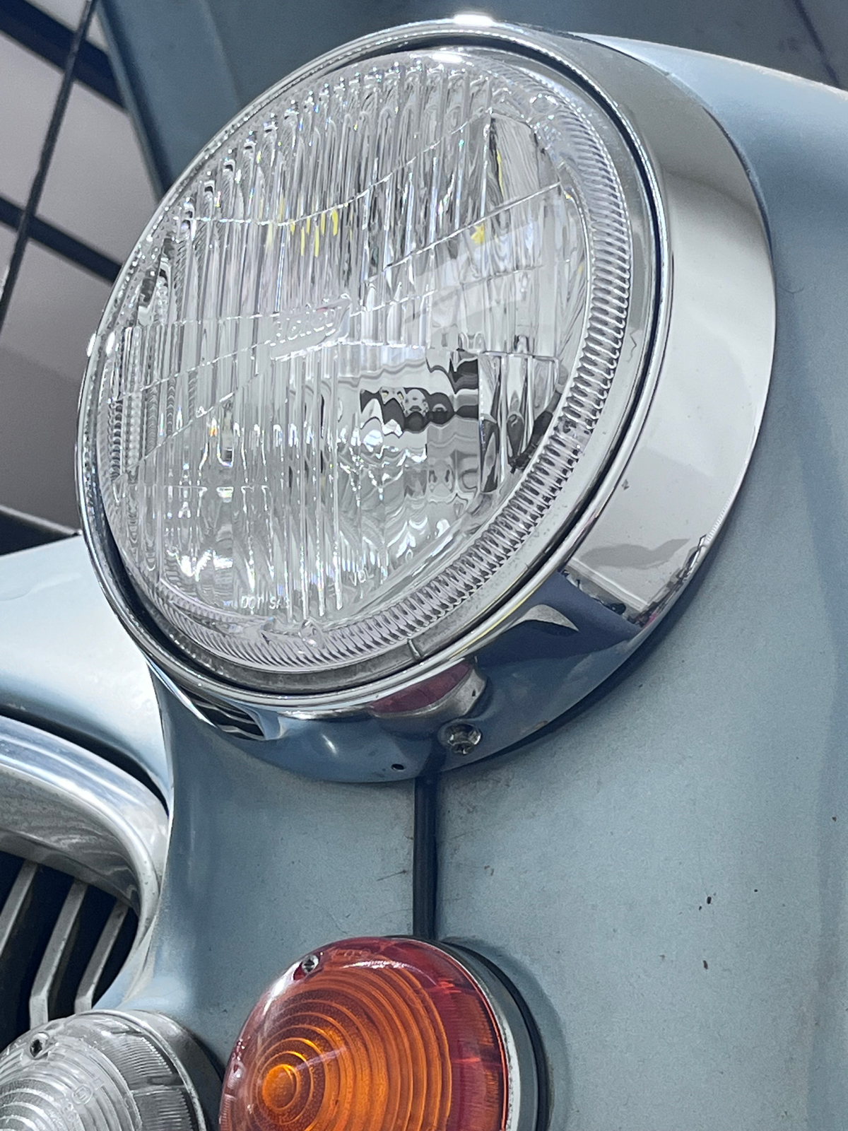

That said, I had the choice of going with the slightly amber or warm LEDs or else the brighter blue-white modern LED arrays. I chose the latter because I leaned more toward what I felt is superior lighting conditions under testing. I mention this to emphasize that my focus was on the lighting quantity and quality.
The name "Holley" is certainly visible but not objectionable to me.
Below are photos . . .

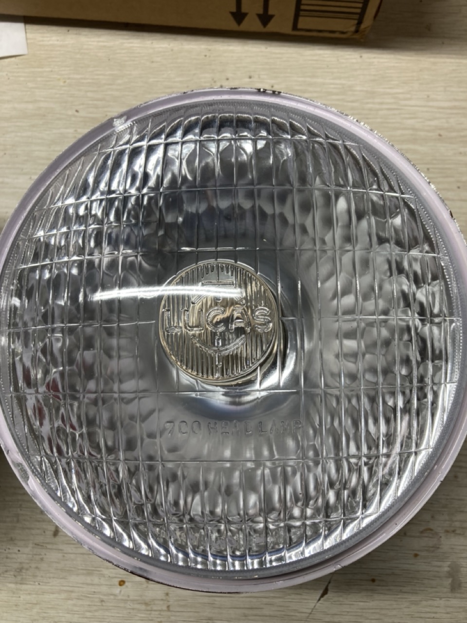

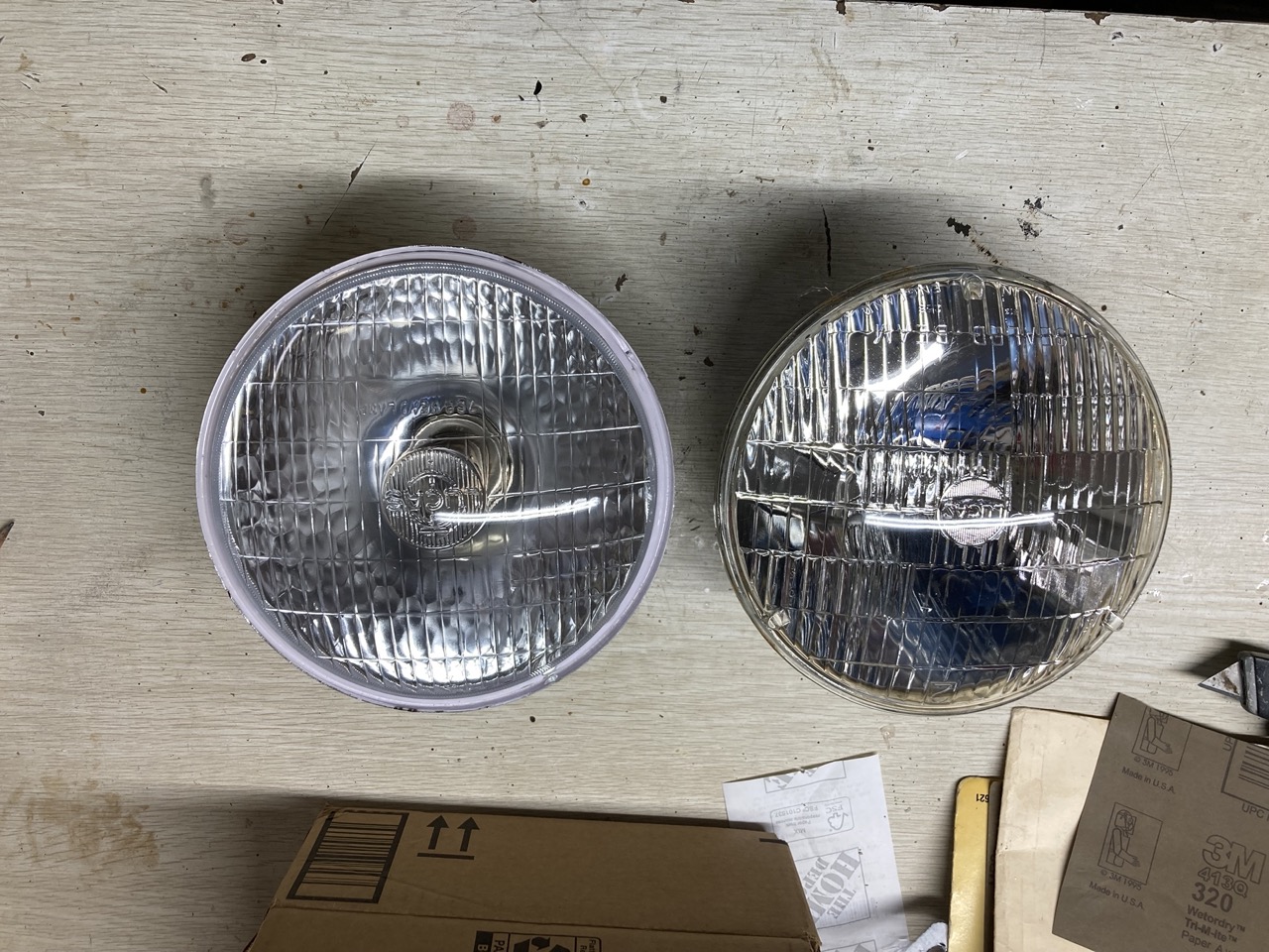

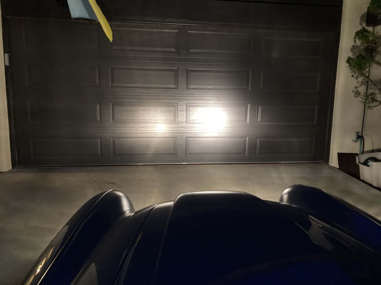

The India made headlights arrived yesterday and I thought I'd give you my evaluation.
The Good News
They were very cheap. $45 for both delivered to California.
The shipping was quick. One week after ordering.
They are labeled Lucas, although the logo is not quite the same as an OEM.
The supplier was good in communicating with me.
The Bad News
They were very cheaply made.
The lens is very cloudy. I guess that why the photos on ebay are a bit out of focus.
The overall quality is bad. Bulbs were made poorly, lens were not sealed to the reflectors all the way around.
The reflectors have a segmented surface which is not that noticeable since the lens are cloudy
The lens are thinner than the original so you have to install a gasket behind the unit or it will rattle and twist in the mount.
There light pattern is not very focused and the low beams are directed 15 feet in front of the car.
Bottom line, they do produce a bit more light than the OEM Lucas units, but nothing to rave about.
Because the lens are so cloudy, the car now appears to need cataract surgery......
So, this proved the adage that you get what you pay for. If was a fairly inexpensive lesson and lead to a good discussion of the forum so that is worth something. I'm going to put my old OEM Lucas bulbs are back on the car once I locate one more usable unit. One of mine lost the low beam.
Photos below
1. Looking thur the back of the new unit to show how cloudy it is.
2. Side by side New and OEM
3. New unit showing the strange segmented reflector.
4. OEM Lucas units on High Beam
5. New version on High Beam.

Excellent report. Thanks.
Good article Bob.
