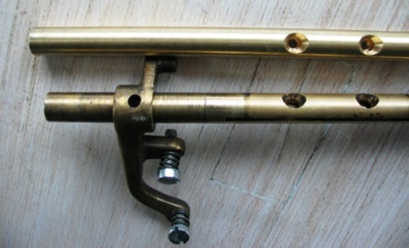

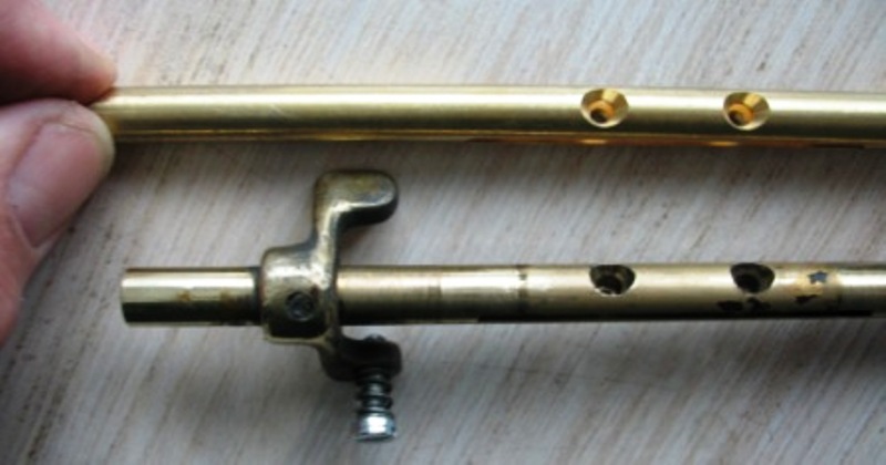

Keep the old spindle shafts and make sure you cut them to the correct lengths. Also make sure that you drill the hole for the brass adjuster stop arm at the right angle so the butterfly plate will be set correctly relative to the brass stop arm.

It's interesting that others experiences have been so different than mine. My carb bodies were significantly worn (especially the frontmost bore), while the shafts looked only a little worse than Don's photos above. New shafts in the old bores were still loosey-goosey.
nice pics Don. what kind of setup did you use to drill the hole for the pin? While we're on the subject,The Su repair kit I got from the UK had cheap screws to hold the discs to the spindle compared to the original. When I went to epand the slot in the screw after installing on the spindle half the screw broke off. I hate to be a whiner but it just seems that the aftermarket stuff for British cars seems flimsy or cheap when laid side by side with parts made in England 50 years ago!
I scribed around the rod where the hole should go, held the brass rods in the aluminium jaws (one at a time) in my bench vice and eye-balled while I drilled the small holes for the pins. I kept comparing the hole angle and position for each. If you're out a bit one way on the angle, that's no problem as you can screw down a bit more on the screw once it's all assembled. But if you mess up the angle of the drilled hole the other way, you can have the bottom flat end of the screw flush or recessed up into the brass foot and the butterfly may not be able to be set closed because the bottom face of the foot of the brass "thingy" is resting on the stop or body of the SU carb.
If that happens, all you can do is file away a bit of the bottom face of the brass foot or file away a bit of the top face of the stop on the SU carb body.
As for the two tiny screws, I can't remeber but I may have re-used the original screws. I can't remember spreading the slot to lock-wedge the screws into place.
