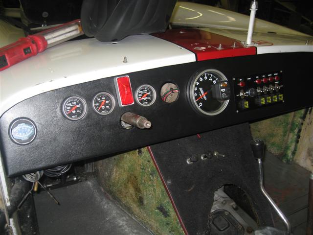

We finished cutting the dash today along the lines of the pattern I posted a few days back. We used .050 aluminum with a U-channel bent into the bottom and an L turned on each end for stiffness and appearance . I'm going to finish it in a nice black crackle paint and will post a picture in a couple of days when done.
I wasn't happy with the way the crackle paint came out--the texture seemed to vary from spot to spot--so I wound up covering the dash panel in black vinyl. Attached see a photo--the empty hole is for a voltmeter which should arrive tomorrow. The switch panel is Moroso and the gauges Auto Meter mechanical.
Thanks to all for the advice and tips.
Best--Michael Oritt, Elva Courier

The secret to the wrinkle paint is heat. On a 90 degree up day nothing more than the power of the sun is needed but any other time I use a heat gun. The secret is to preheated what you going to spray and then keep the heat to after you spray it until you see the wrinkle come up on the surface. I used this method many times with great results.
