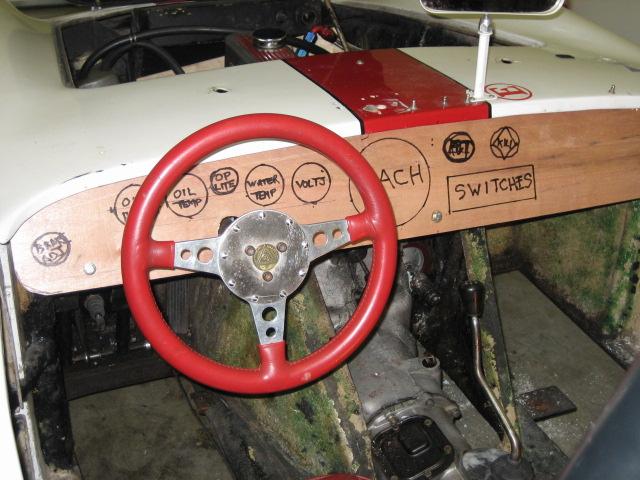

Michael Oritt
Michael Oritt
Dave--
I like the Pinto's dash--very functional. Attached is a picture of my initial template for a new dash for the Courier. I'm using the small Auto Meter guages and the 5" Monster tach.
Best--Michael

I wouldn't say I'm a gauge hawk or anything.
(I check them once per lap after exiting the last turn)
I really never look at the tach either.
I just hold her to the floor until it is out of cam. (about 5800)
Looks like your spending some quality time in the garage this winter. /ubbthreads/images/graemlins/yesnod.gif /ubbthreads/images/graemlins/thumbsup.gif
