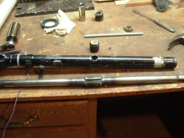

Re: disassembling steering column
well, the ignition lock is off and now the mystery is solved,there is a slot in the column that is located in a built up area on the column. but you still can't remove the inner column unless you remove the steering wheel and then you still have to remove the bushing at lower end. The bushing at the top end is staying because I'm not prepared to take that bell housing off that holds the directional and high beam switches, and unless you remove that housing you can't get a new bushing in. To make matters worse, I had to hammer on the end of the column to eventually work out that bottom bushing and really mucked up the threads, the book lists the thread on that end as 9/16 whit, which appears to be a 28 count thread. What does whit mean? Had I known what a trial this would be, the old bushings would have been just fine.
PS. Thought I'd save Skip a little trouble :bow:
