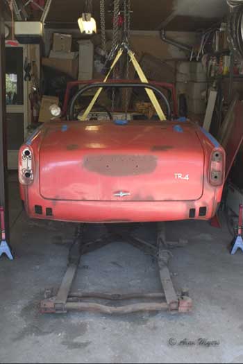

As to lifting the body off the frame, it's not nearly so big a deal as you might think, especially if the interior is alread removed from the car. Get hold of a manual and it will likely give you a step-by-step of what to remove (the TR4 & 4A manual does, I haven't looked in the TR6 manual). Most of it is obvious, though.
Next is something to lift with. I bought two 1000 lb chain hoists from Harbor Freight or Norhern Tool. Cheap ($40 apiece) and nothing fancy, but one will also work to pull and install a TR engine/gearbox, instead of renting or buying an engine hoist.
Securely fasten the chain hoists to the ceiling, roll the car under and lift away. The best/factory recommended lifting points are the hood hinge mounting points (I made a pair of heavy brackets to bolt up there and connect an "engine leveler" between them, to which the chain hoist attached... this allowed me to adjust the car's level, side to side) and the seatbelt mounts inside the cockpit (I just used a heavy tow strap wrapped numerous times around the roll bar that's in my car, instead).
This was the first time for me and I definitely will do a TR "body off" again. I did all the work by myself, with no assistance. The chassis and running gear is *all so much easier to work on*!
An alternative is to completely strip the body to the bare center section and feed a bunch of friends pizza and beer after they help lift it off. The stripped body doesn't weigh alot... maybe 400-500 lbs. 4 to 6 people can lift it.
But, you are then faced with what to do with the body, the car suddenly takes up double the space. (I left my TR4's body hanging from the ceiling for several days... Oh, and I did put some extra vertical support posts from the garage floor to the ceiling, supporting the 6 joists to which the chain hoists were attached.)
It's really easy to work on the chassis once the body is out of the way. This is especially true when replacing fuel lines, brake line and front and rear suspension components.
I lifted the body with many parts still in place. Just the hood, front and rear bumper were removed. And, the windshield, to avoid any cracking. (The frame was still on my car, but the glass was removed.
The door openings should be cross-braced to keep the body from "folding" in the middle. Many weld in a brace, in such a way that the doors can still be installed and test fitted. I think it would also be possible to brace from the hoodstick mounting bolts to the windshield bracket mounting bolts (if the dash is removed), rather than welding. I *did not* brace the doors on my car at this time, since this was just a "lift, out with the old, in with the new, and lower" job. The doors were left in place, not opened during the entire time, and served to brace the door frames. I will tell you the gap at the top of the doors securely closed up while the body was lifted, so I really don't think there would have been a way to open and close them.
I *really* lucked out when lifting the body, didn't even think about it until the last minute. I failed to consider how much space would be necessary to roll the rebuilt chassis under the car. Turns out that the new chassis was 34" tall, at its highest point. The lifting rig I set up with the chain hoists etc. reached its limit with the car body 35" off the ground! One inch to spare! Too close for comfort! (Pulling the old, stripped chassis out was no big deal, just a matter of removing the jackstands, letting it drop to the floor and sliding it out from under the car.)
I *highly* recommend you get Roger William's "Improving Triumph..." and "Restoring Triumph..." books and read them thoroughly first. They provide a number of important frame reinforcement ideas that alone are worth the cost of the books. For example, the differential mounting bolts on all the IRS cars should *always* be reinforced, while you have easy access.
Attached is a photo of the TR4 hoisted partways to the ceiling.

Please reread my response from yesterday and view the attached photo. That's a substantailly complete TR4 body being lifted off its original frame (which is on the floor in the photo) in preparation to roll a refurbished frame/drivetrain underneath (photo of the frame/drivetrain attached here).
There are some detail differences between TR6 and TR4, but the basics are the same.
Lifting like this makes working on the frame/suspension/drivetrain very easy.
This procedure is *not* recommended for body work/paint.
In my case, the original frame had some accident damage that I intended to repair. However, I had the opportunity to buy a very solid, straight, almost stripped frame. Using that, I built up the car from the ground up, alongside the old frame. This made the process so easy I'd seriously consider buying a second frame before starting any future restoration project!
Think about it. This is essentially what the factory did originally. They married a largely assembled body to a mostly completed frame/drivetrain.
Biggest concern is that you'll be lifting approx. 1000 lbs and some safety measures should be taken. It's not recommended to get under the hanging body and work on it in any way. The doors don't absolutely need to be braced, but won't be possible to open, either. I'd not leave them "jammed" like this for too long, either. It is possible to brace the doors with a bolted up brace, rather than welding, too.
Be very sure to unbolt and remove the windshield/frame, or any flex might crack the glass. This also gives you more clearance for lifting. The hood (bonnet) will have to come off. The carpet will need to come out to get access to many bolts, so the seats will need to come out temporarily, too. Fuel lines, wiring, brake lines will need to be disconnected, some removed. The radiator shroud and carburetors/manifold will need to be removed. Heater hoses need to be disconnected/removed. Bumpers and their brackets will have to come off. There's more, hopefully you can find a book. The removal and lifting process could probably be done in one day. It took me a full day to install the body onto the different frame and bolt it up... mostly time spent fooling with all the mounting shims to get a good fit. (Re-fitting a body to it's original frame would take less time, so long as careful notes are kept regarding how many shims were originally used at each mounting point.)
I am doing this work in a two car garage, wish I had a three car garage or larger! But, I know someone doing similar work in a one car garage.
I do plan to take the body back off the frame. This is just a trial fit, to make sure all the new and refurbished bits and pieces are playing well together. Next time it's lifted, the body will be stripped for final body work and painting. But, the frame/suspension/drivetrain is now pretty much done. The "new" frame needed to be under the car before certain body replacement panels could be properly fitted, anyway.
The TR4/4A factory manual shows procedure for lifting the body as a unit and gives a list of minimum items needing to be removed or disconnected. I just looked in my Bentley manual for TR260-TR6 and don't see a similar guideline. Perhaps one of the other manuals or restoration books give those details.
Hope this helps!
