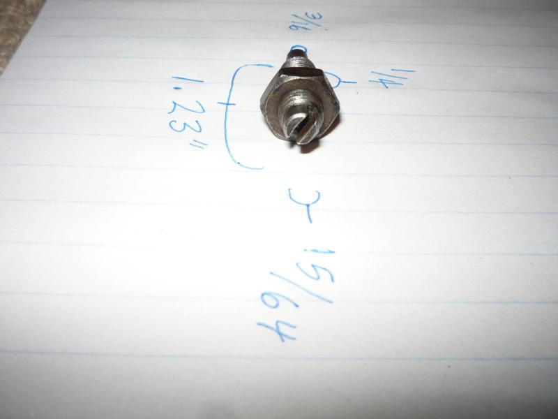

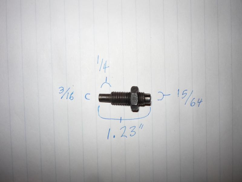

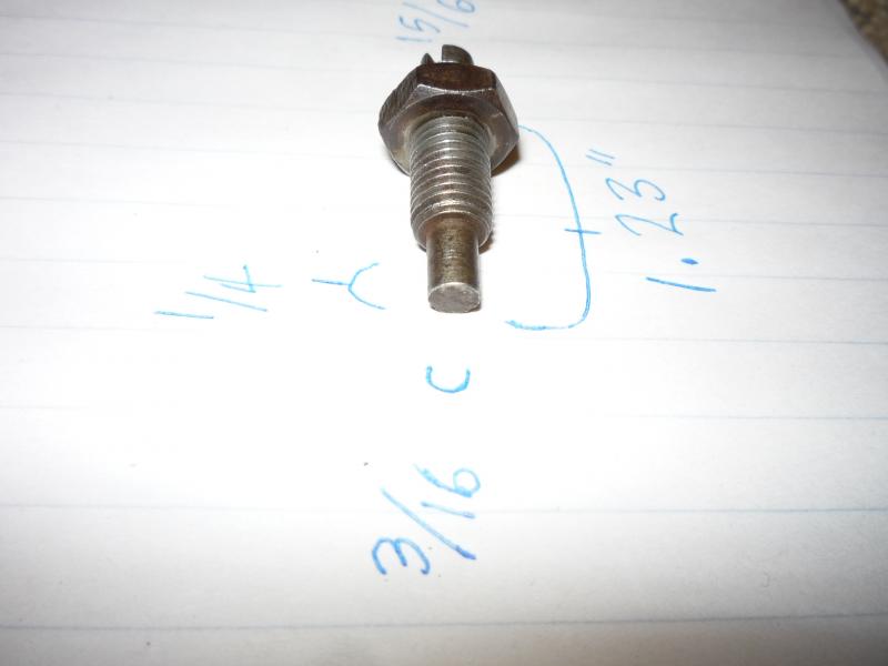

I'm in the process of rebuilding a Girling 10" brake and find I am missing the steady posts. Does anyone know of a source for these or even a rough drawing and I could make them maybe.
TR3driver
Great Pumpkin - R.I.P
I've got some somewhere. If no one else chimes in by tomorrow, I'll start hunting for them. Don't really want to let them go, but at least I can get detailed measurements for you.
From memory:
The thread is British, but I don't recall offhand if it's BA or BSF (or BSW). They're about 3/4" long (but 1" would work OK). Screwdriver slot on the outside end, inside end is turned down to minor diameter of the thread (ie smooth) for perhaps 3/16". Should be a felt collar that goes on there too. TRF claims they have the felt, under P/N 7H4429
PS, Welcome to the asylum. One tip: It's usually better to start a new thread with a new question, even when it's related to the original question. Usually, you'll get more responses that way.
PPS, Perhaps I'm mistaken about the British threads. TRF says that a JN2108 will work for the jam nut, but JN2108 is 5/16 UNF. I still don't think that is correct, but it has been a long time since I had to fiddle with those dang posts.
TRopic6
Aloha A-46,
I dismantled an early 3A axle to get diff gears & 10' brake parts for my '59 stored in SC. I disassembled the back plates to sandblast and managed to keep the posts aside in a place I could get to them. Here are a few shots; pretty much as Randall remembers. Threads are regular 5/16 UNF; I ran a regular nut down the threads no problem. Maybe you could mill one out of an old bolt.

sp53
yeh my 10 inch are like Randall’s picture, and if I remember correctly the springs have to go that way or the full spring will rub on the wheel cylinder rubber. I am also pretty sure those are 9 inch in the picture or they hobbled 10 and 9 together.
TRopic6
I measured them all and they range from 1.228 & 1.248. Maybe they started life at 1 1/4" and wore down in service.

Could be! On the TR3A I had back in 1977, those pins were so out of adjustment that I would hear a mysterious "clunk" shortly after releasing the brake pedal. The shoes would walk out to match the drum when the brakes were applied, then snap back when they released. I can't prove it was wear, but it seems the most likely explanation. There was visible wear on the shoes as well.
