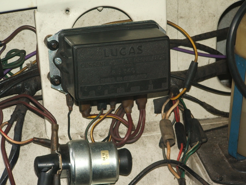

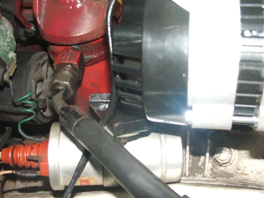

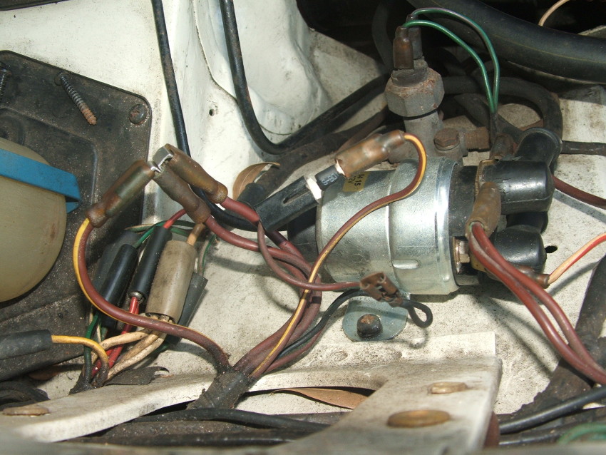

Did it a while back on our '64 MGB, after converting to negative ground. Mechanically, had to modify the rear mounting bracket to fit and cut a bit of material from the shield attaching the coil. Hard to see in the photo. Then more-or-less temporarily "hot wired" the circuitry according to instructions, to by-pass the regulator (used a Lucas internally regulated alternator). Installed the faux regulator from Moss, re-attached the wires and replaced the generic cover with an OEM Lucas one.
