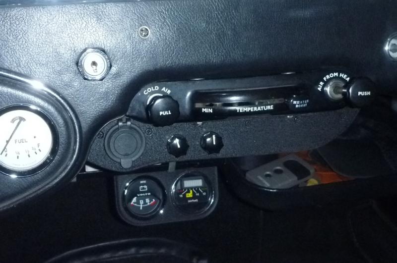

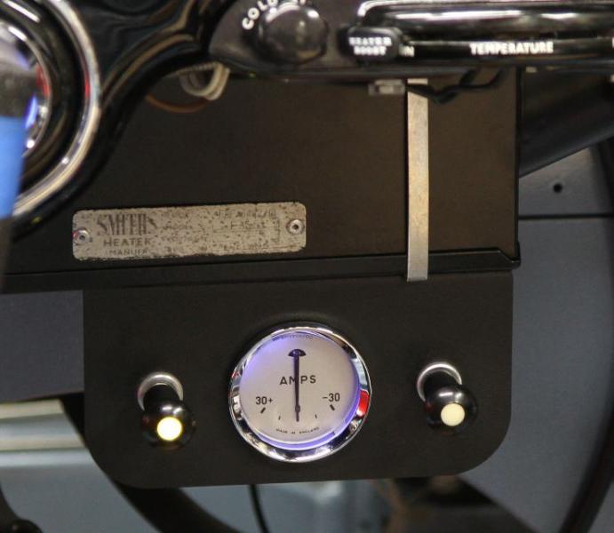

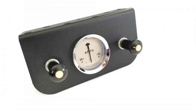

I'm finishing installing some factory options on my BN6, (an original Smiths ammeter, L494 reverse light, and SFT 576 fog lamps.) and had to have a mounting bracket made to mount the gauge and the switches. It turned out that the shop liked my design and decided to offer the bracket as a regular product (No interest, just a happy customer).
I thought there might be some interest on the Forum. Link: https://www.cubbypods.com/#!universal/cdvt

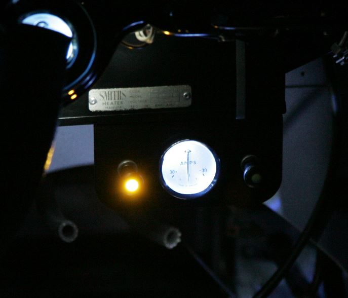

Yes, the centers of the switches do illuminate when the switch is on. I've replaced the regular incandescent bulbs with LED's for longevity and to reduce the heat.

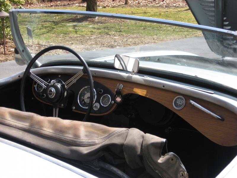

My 100M came with a homemade dash cut from a piece of laminated countertop (don't think that was an original option!!!) with a Smith's Ammeter. Luckily, the previous owner later found the original dash in his parts pile. It had holes cut for an additional gauge and two switches but he patched those over when he refinished the dash. This pod will be a perfect option for re-installing the Ammeter and giving a location for fog lamp switch. Thanks for posting. Already ordered.
