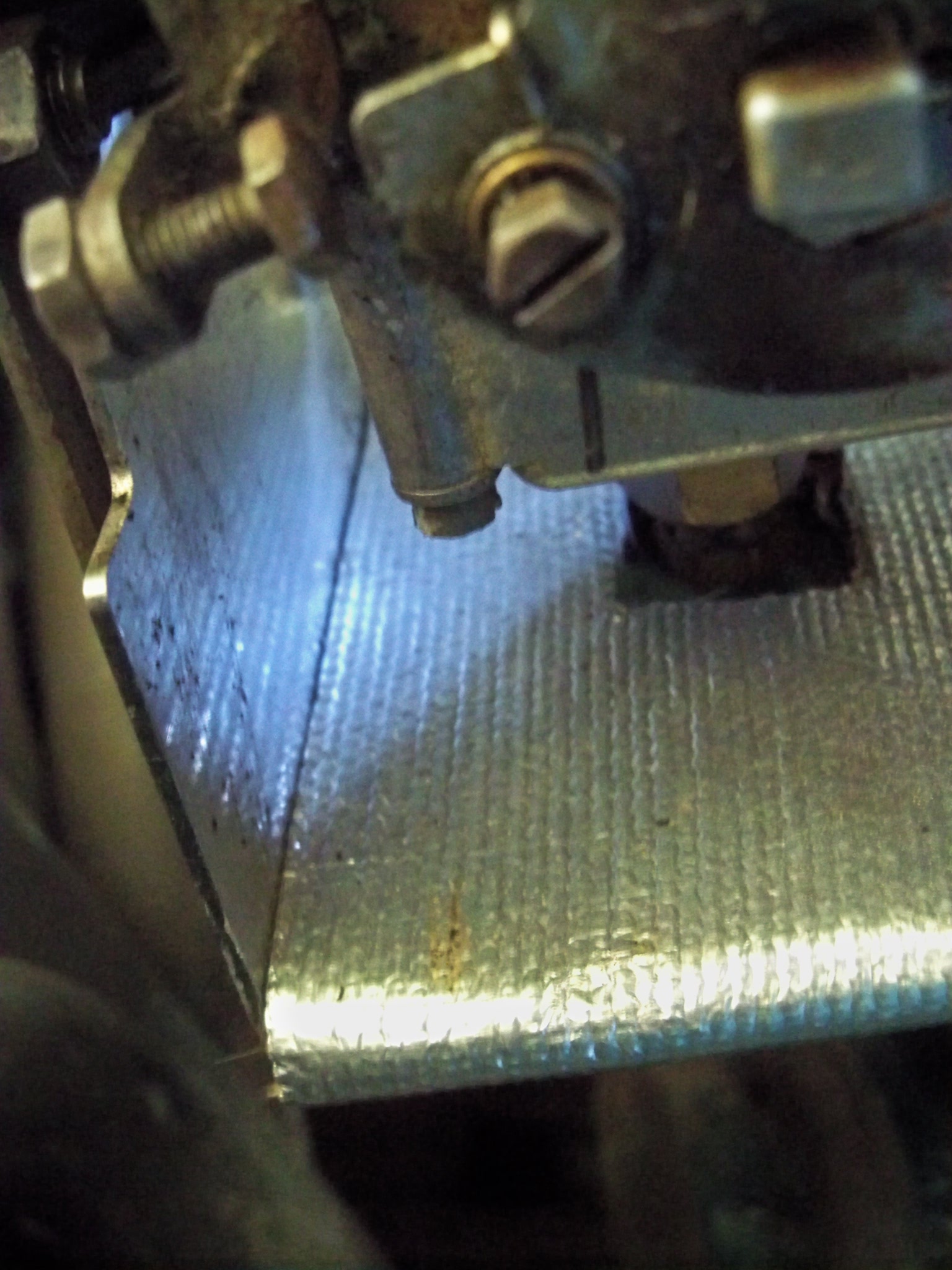

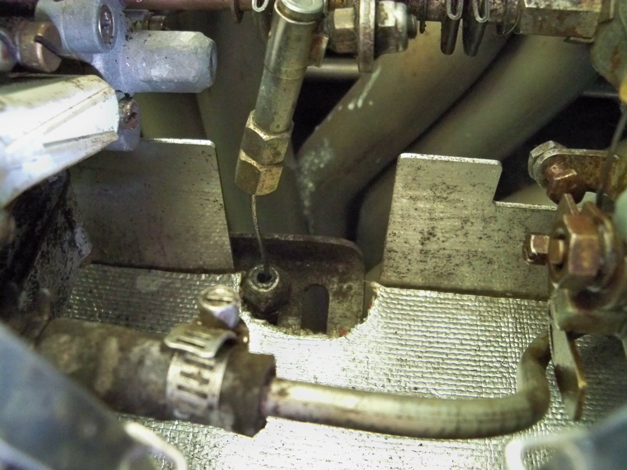

I live in SW Mississippi about 75 miles due North of New Orleans...It's hot from May until October so I've dealt with fuel percolation in the ZS carbs float chambers from the get go.
As long as the car is moving forward with enough air flow and the constant replenishing of the gas in the float chamber, there is no 'boiling' or percolation going on. so I doubt that's what made your engine sputter while you were driving.
Percolation occurs when the air flow under the hood in the engine compartment stops and the fuel in the carbs float chamber stagnates and the heat from the exhaust,manifold and header rise up upon the float chamber.
That usually happens in high ambient temperatures when the car is parked or prolonged idling following a complete engine warm up or a nice drive in the heat. The engine will be hard to start within the first 10 or 15 minutes and when it does start it may sputter until all the hot gas in the float chamber has been displaced with relatively cooler fresh gas from the fuel pump.
If it happens to you again when you are driving, reach back and open the gas tank cap and leave it loose,see if that helps.
Otherwise if you are really dealing with percolation, you need to protect the float chambers from the manifold heat.
I solved the problem with a heat shield that I layered with heat insulation material in order to make the heat shield effective...without the insulation, the heat shield didn't do much to prevent percolation.
You might also if you haven't consider an electric fan to keep the air moving when you are just sitting at idle.

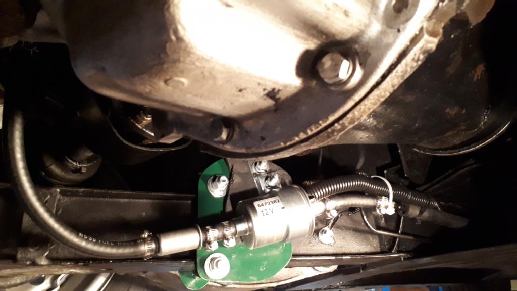

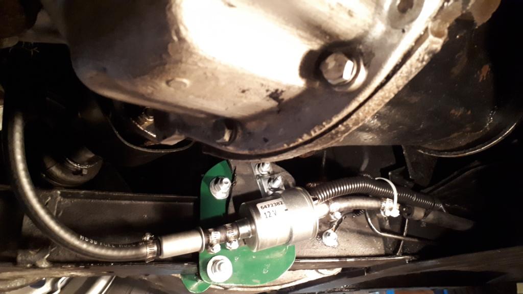

I attributed my issue more with vaporization in the line,
as I could drive 3 city blocks away from the last stop, before it would stall out.
After implementing some of the remedies, I installed an auxiliary free flow 2.5/4 lbs/ft electric pump.
By raising the pressure of a fluid, it also raises the boiling point. Bowls are still at atmospheric pressure.
I use it on start up, on the hwy, but mainly in stop & go traffic. Otherwise I use mechanical pump only.
After stalling out due to fuel starvation ~10 times, this has been working out good.
When I feel hesitation in fuel delivery, I flick the pump on & the response is noticeable.
Rock Auto & GM dealer sell the same after-market part they promote as genuine AC Delco.
The first pump died after ~2hrs of use, spread over 1 year.
I made a shackle w rubber mounts to attach to the frame.
I'm no expert, if there are flaws in my theory, feel free to point them out.

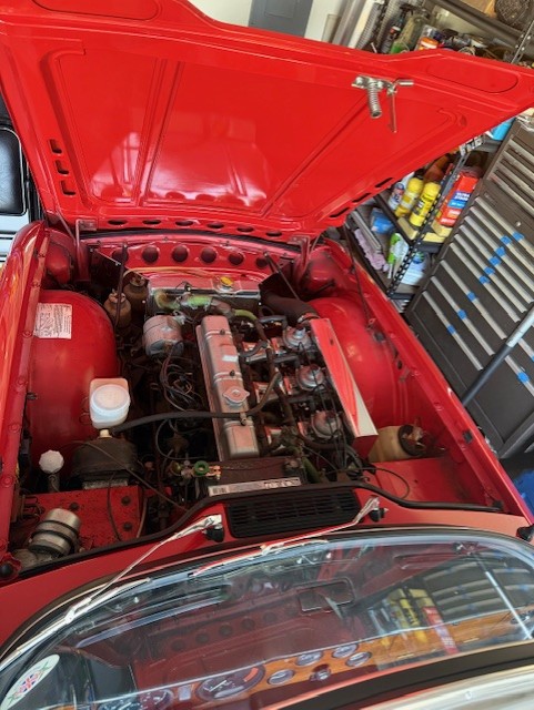

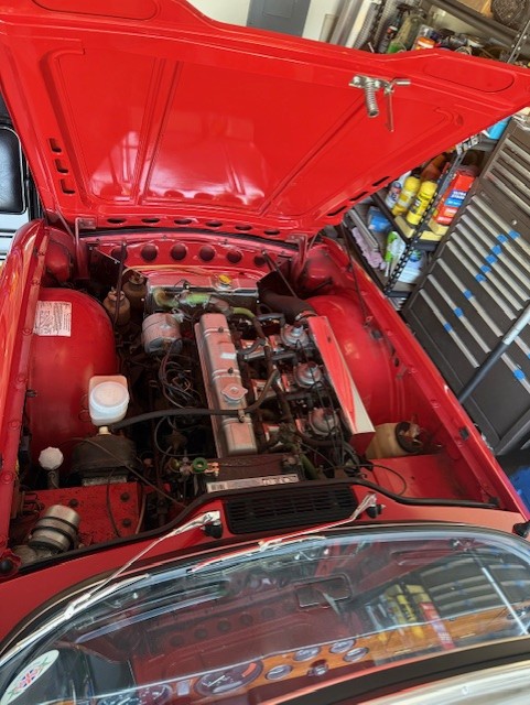

My fuel pump is also new. I got it about 2 months ago as well from Rimmer. The Moss one I got about 3 years ago had some weird adhesive on the diaphragm that worked its way up to the float needles. That caused a flooding disaster until I put in a secondary fuel filter. Well, all that's resolved with the new pump. There could be something to the lean fuel mix. I've inspected my plugs several times. They look normal to slightly lean. No question. However, it isn't severe. I do have the Goodparts tri carb setup. So, maybe I need just a bit more pressure? Could it be that the mechanical pump just isn't keeping up? Not sure, it doesn't seem to be an issue until it's been running for a while.
Yes those carbs could be the issue. Why not ask Richard what the recommended pressure is for a three carb setup, and then check with a pressure tester. Hot fuel and incorrect pressure can cause issues including rich running if the floats are defeated.
