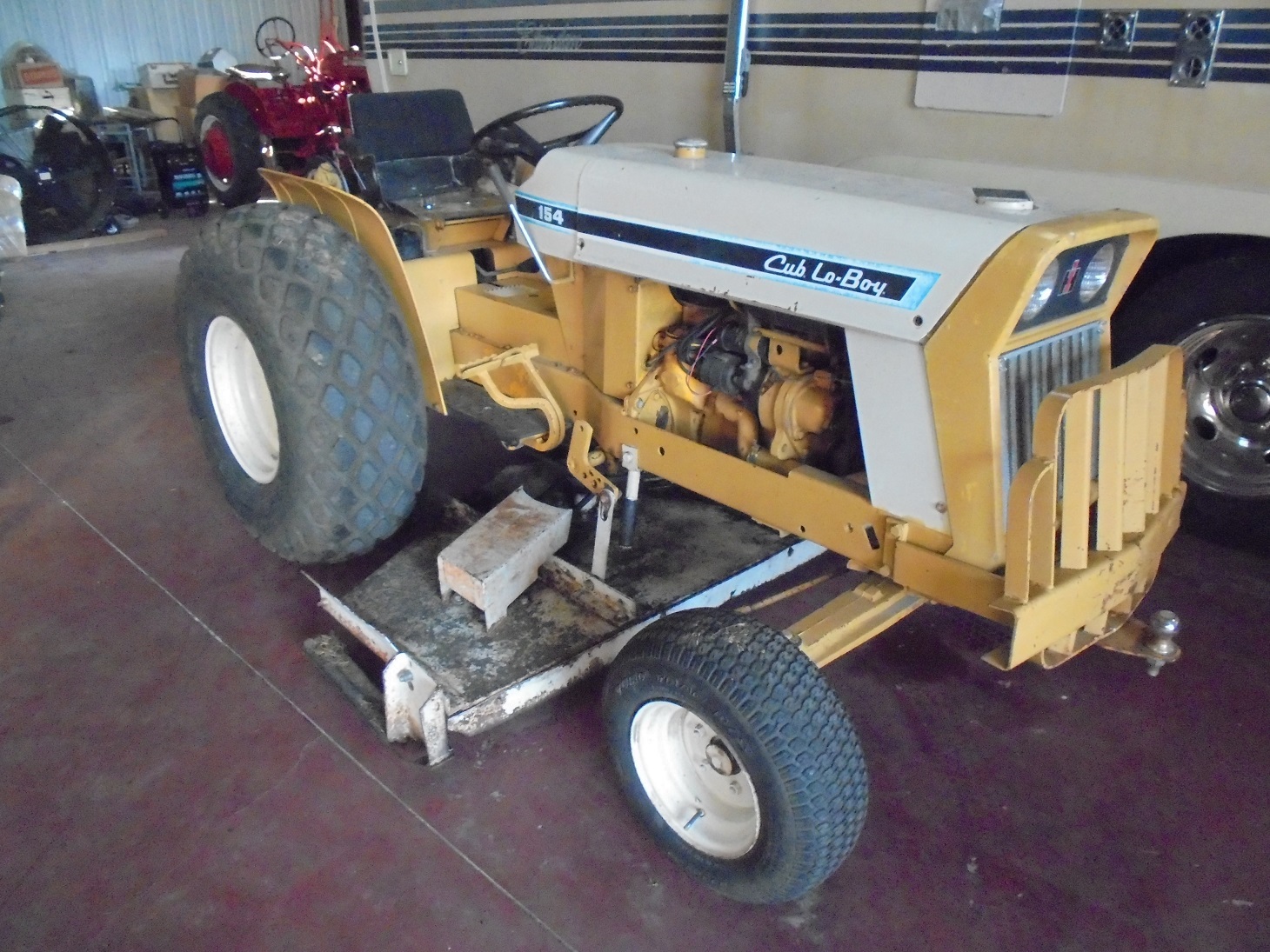

Which IH do you run Paul?
It's 154 International Lowboy Walter I use for trimming fence lines.
One of the last IHs. Those were pretty decent little tractors.

I would love to find a IH Cub Lo Boy as nice as yours. The few for sale around here are used up and worn out!
When I bought this one I had to replace the clutch, flywheel and driveshaft, plus I replaced the PTO clutch assembly, new belts all around and numerous other things. Gave $2500 for it and spent another $1000 getting it usable. There is a parts dealer in Ohio that has just about everything for them. It is old but has the sweetest running engine you could want. I use it all the time. PJ
