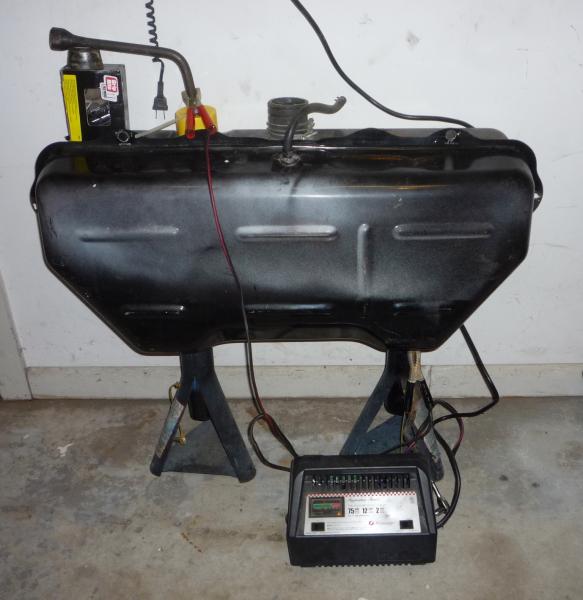

I bought a TR6 that had sat for many years and the tank needed to be cleaned out. No pin holes, just "gunk" in the tank. I used the electrolysis method and it did an "alright" job of cleaning the tank.

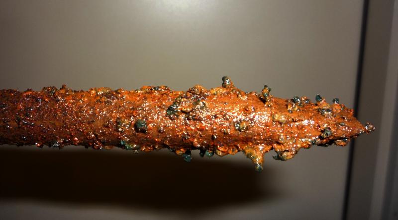

The tank was filled with washing soda and then I hooked it up to my battery charger with a old tire iron to suspend in the electrolyte solution. It took a couple of days but it collected lots of rust on the anode which I removed and cleaned everyday. After a couple of days hooked up to the charger I emptied the tank and used a hose to flush out all the remaining flakes that had come off in the cleaning process.

Elliot - interesting idea, which I might try myself. I've heard of that method before.
What exactly do you mean "fill with washing soda"? Washing soda is a powder - so do you mean some diluted mixture of it in water?
Tom M.
Exactly Tom. Plain old Arm and Hammer Washing Soda mixed into warm water.

Make sure to dry it out for a couple of days and keep rotating the tank to get any trapped liquid out.
That's a definite, but always problematic with the baffles inside the tank. When I get to removing and cleaning the tank, I'll probably also used compressed air. I assume you did this, then followed with some professional coating system?

No, I did not coat this tank after the electrolysis cleaning... Cleaned it, let it air dry for days then reinstalled. Rotating the tank will dislodge any liquid trapped by the baffles.
