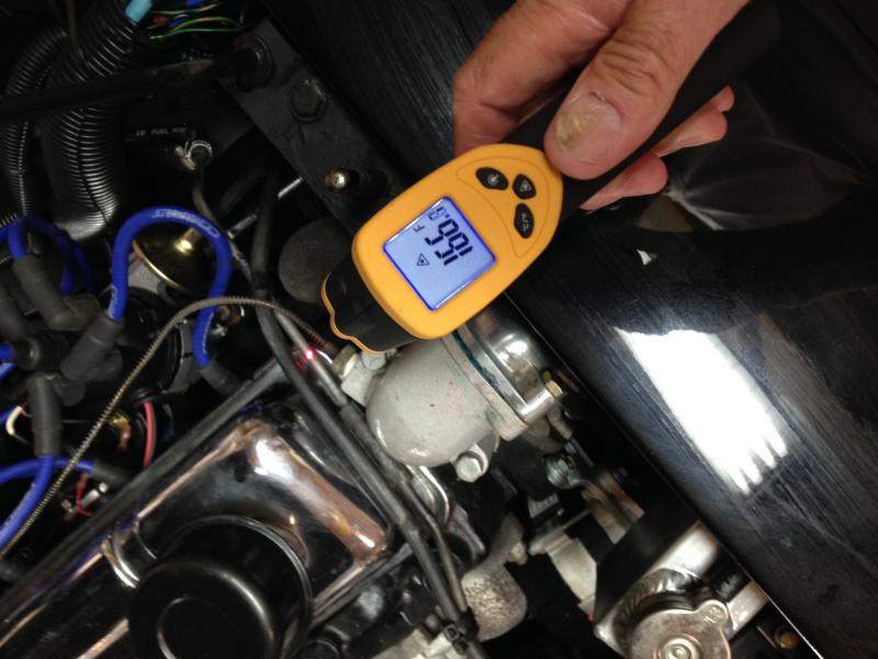

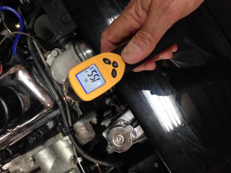

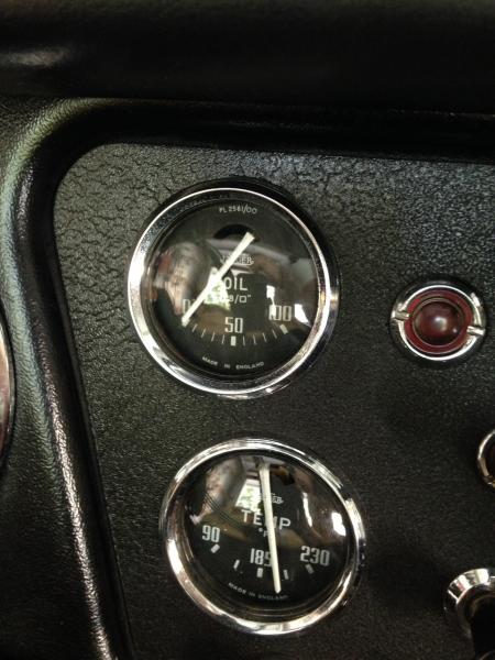

FWIW:
regarding Bob's original post:
warmed my car up for 30min. At idle, to take a laser readings on my metal tube fuel line:
note: my current fuel line location is not the standard location, but it is probably hotter( in one location) than standard, located right behind the thermo. Housing.
temp. Gauge reading 185++ ( about 1/2 way from the 5 to the next mark.) (normal for mine)
my tube comes off a pressure regulator on driver side wheel well, not parallel to the engine block:
registered 100 degrees at tube/hose junction.
behind thermostat sender: approx. 160-170 (I use a make shift thermal sleeve of split fuel line)
opposite side of thermo housing: 155-165
just for the sake of measuring:
Forward bowl cover tube housing: 100
top of "u" tube: 95
middle of "u": 95. ( I have a carb heat shield in place)
also, I found I had to put a shield between the manifold & the FL to get an "accurate" reading.
& when my puller was operating, I found it also drove the heat up artificially.
it's about 88 degrees in the garage & the hood was up & open the whole time(fwiw)
......can an you tell I'm bored today?
