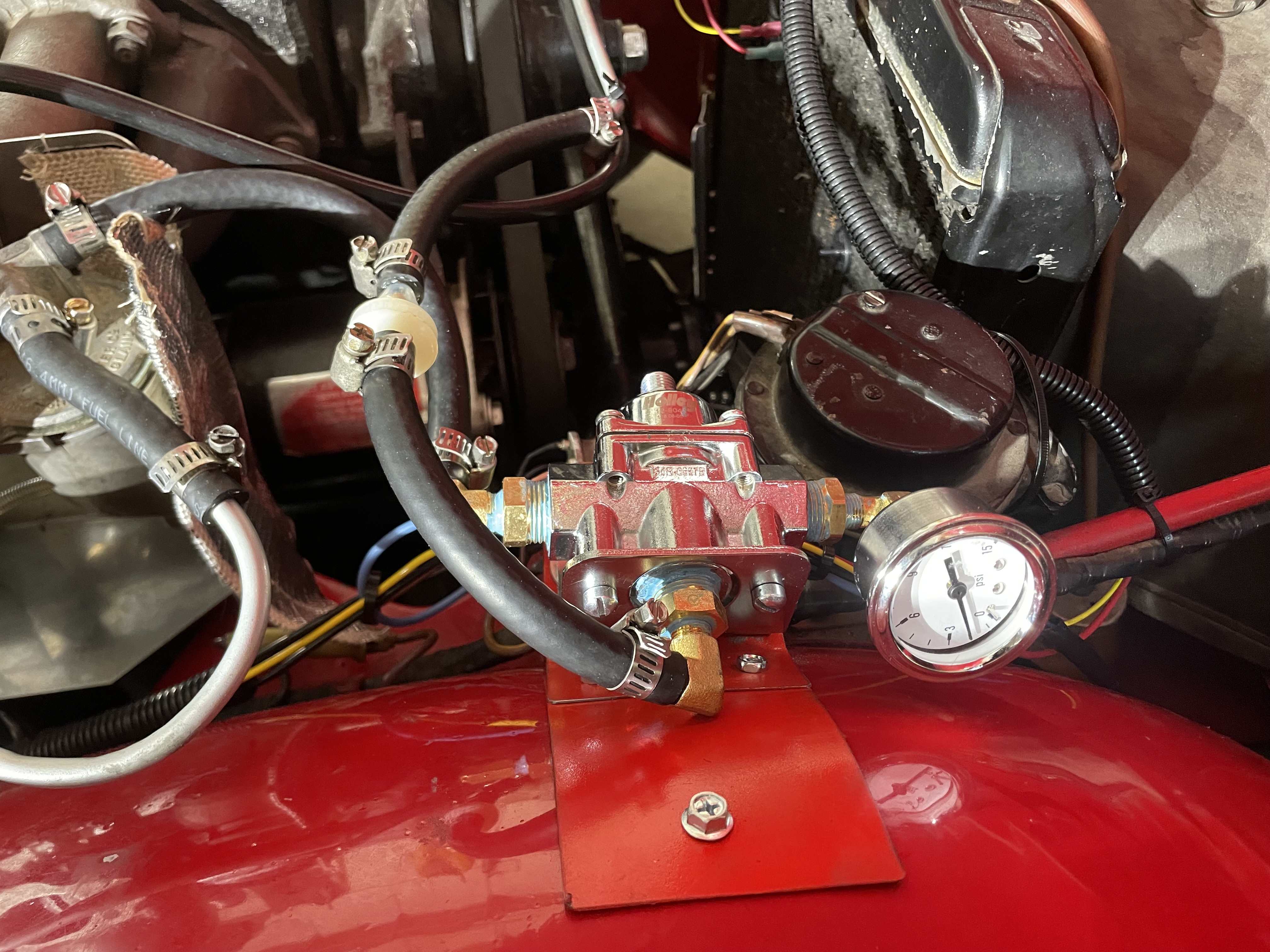

I installed my fuel pump pressure regulator. See pic. Nothing I could do would make my floats operate properly and I was continually flooding.
A few days ago, I tried adjusting the floats way up, then way down, and nothing made any difference.
I had near 4 PSI from the pump, and the recommended maximum is 2.5.
I’m not ready to declare victory yet, but I finally have floats that are operating the way the Triumph Manuel suggests. My fuel pressure is now set at near 2.2 psi.
I’m not seeing any flooding, and using the “lift the piston method“ I’m finally able to make some sense of the mixture adjustments. We’ll see.
I’m still not convinced I won’t be towed back home again soon.

That Holley regulator is a good unit. I have also had the problem with mechanical pumps forcing fuel past the float valve, so all my older cars have electric pumps and that regulator. I keep it set around 2 PSI; you don't need more.

Electric usually puts out too much pressure. Try to find a 2.5psi electric...?
For true performance, the electric with regulator was the way to go prior to fuel injection. You could place the electric pump at (or in to keep it cool) the tank and pressurize to 14 psi or more. Then regulate it at the carb down to 6psi American, or 2.5 psi British. The extra pressure prevented vapor lock. We used to launch cars at 1 G force, so the 15 feet from the tank to the carb was like pumping fuel 15 feet straight up! You would loose 10 psi on the launch alone.
And, "yes", if you add anything to a TR, you will need to upgrade the charging system. The TR3 puts out 21 amps. Ignition is 2amp, Headlights are 10amp, and running lights about 4amps. Drive at night in the rain with the wipers at 6 amps and you are already overloading the dynamo! If you add an electric fan, electric fuel pump, or a radio, it would be a good idea to upgrade the charging system. Or, you could switch the lights to LED and perhaps delay the upgrade.
That was my thinking when I switched to an electric pump. My TR4A has a nice Carter pump mounted near the fuel tank and putting out about 6-7 PSI. I regulate it down to 2-2.5 PSI at the carbs. You can find lower-pressure pumps, but the specified output pressure range can still leave you with too much pressure. I went to the higher-pressure pump, figuring that it might provide some resistance to vapor lock, and the pressure regulator keeps it pinned at the desired pressure, with virtually no variation.
My only objection is that the Carter pump is noisy, enough to be annoying. I may replace it only for that reason.
