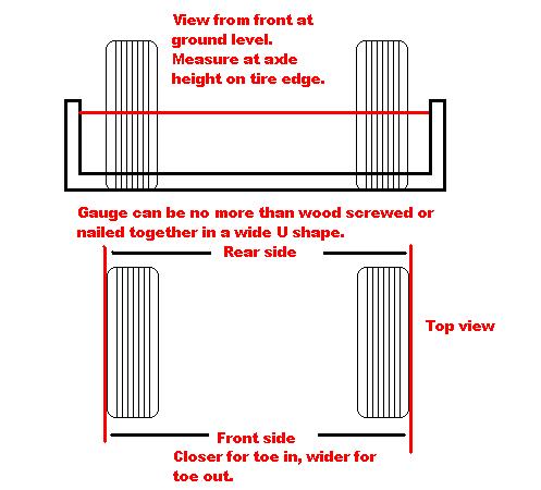

There are numerous ways to check alignment, from the string method to use of a simple toe gauge. Personally I like a simple U shaped toe gauge as I can set it up quickly and easily use it myself without help. I don't like the Moss gauge as it's design really seems to rely on a lot of operator adjustment to make sure the angle pointer is correctly set against the tire to get an accurate reading. I prefer a comparison reading from both the front and rear of the tire and comparing the two, that eliminates any uneven wear on the tires from factoring in. What you are determining is the difference between the width of the tread at the front and rear sides of the tire at axle height. As stated above about 1/16" to 1/8" toe in is the norm, most cars's I've dealt with over the years call for about 1/8" toe in. Toe out is preferable for a lot of autocrossers and some racers as it promotes more rapid turn in when cornering, but for the street I'd stick with toe in. Here's a simple drawing showing the basic process.
