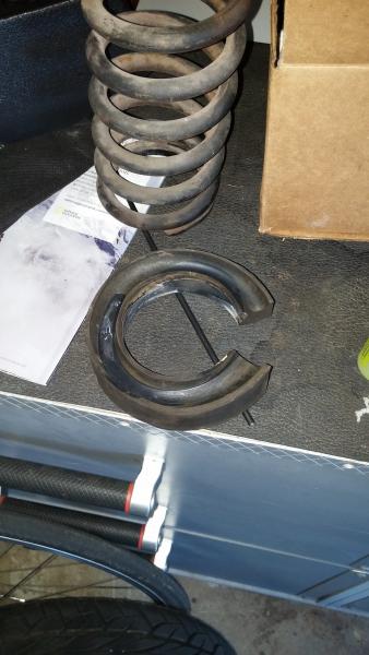

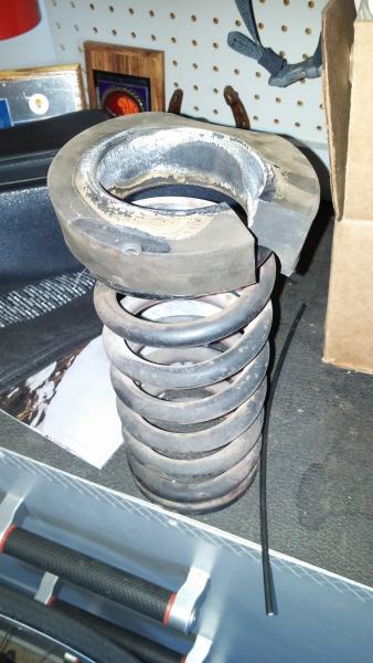

The car had a high front ride height, so today I took it apart. Attached are pics of the springs, which are the same length as stock, with a 1" thick rubber bushing that was at the top of the spring between it and the car. I don't recall this rubber bushing/spacer on my old car, and don't see it in any schematics. Did someone put that there to up the ride height? Is that supposed to be in there?

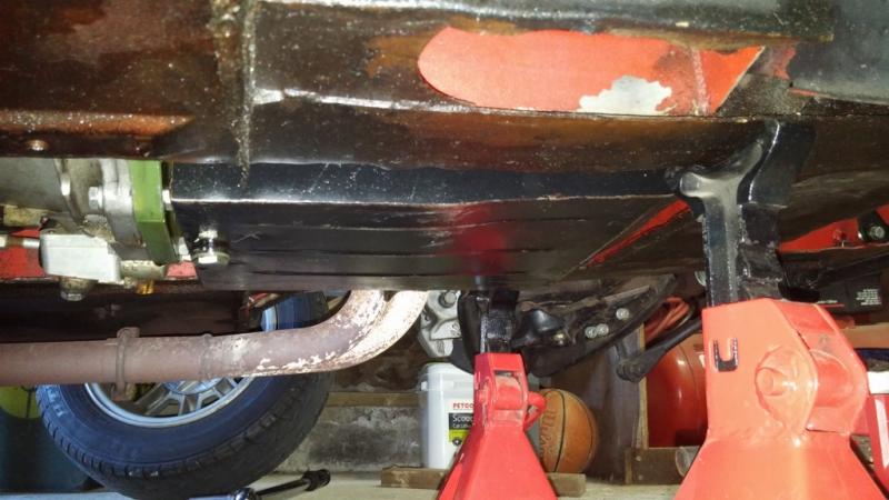

And the oil pan is something I've never seen before.....

looks like someone installed a toilet flange because they couldn't find the correct rubber isolator.
I looked at Moss' schematics, and I didn't see an isolator. Is there supposed to be one, or spring on metal, or??
I looked at the Mini-Mania parts catalog for the Sprite, and it does not show a rubber isolator for either the top or bottom of the spring.
BTW: If you can find one of these catalogs, they are great....listing for original p/ns and great illustrations.
Why don't you simply ask John. Looks to me that you have some special oil b
pan and there may be some trick involved with suspension.
That oil pan goes with the theme of the car. The rear end has a welded in panhard bar, nicely done. The front wheels have spacers shimming the front wheels out a 1/4". I'm assuming someone put the rubber spacers in to stiffen up the front end. Someone loved to rail that thing in its past life. It was nice to get under it today and look things over, the sheet metal is pretty clean under it.
Installing the rubber isolators would not stiffen car spring rates, Sprites/Midgets never used rubber isolators on spring seats. I suspect their was some tire rub and needed to raise ride height to stop rubbing as well installing front wheel spacers. The oil pan appears to look like a Winners Circle 6qt but the drain plug is in a different place. It could be from Tom Coby's Speedwells shop?
Let me quickly add that I couldn't remember if there was an isolator or not - but, have been working on the front end of the Vauxhall - which does have one :)
Your suspicion's are the same as mine...looks like a method to raise the front to avoid tire rub.

K, thanks guys. I'll put her back together without them. I can't see why there would be tire rub on the car, its no different than my last car. Perhaps wheel offset or something like that
or it had different wheels at one time.
Track on a Bugeye for the front is 3' 9 3/4" rear is 3' 8 3/4'. Unless someone had used a wheel with not enough off set or the wheel is wider than 6" shims wouldn't be needed? I think I ran into that issue once before myself, I'm using a 1/2" spacer on the rear of my car so that front and rear are the same track with no tire and wheel extending beyond wings at the top.
When I was running 165/80's on stock rims I had tire rub when turning in and out of parking lot's with sharp entry ramp's. Can't seem to find them anymore so I'm now running 155/80's.
