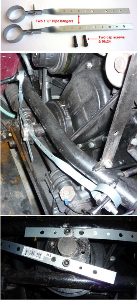

Here's the setup I finally decided to use.
Two 5/16"x24 cap screws
Two 1 1/2" pipe hangers.
Total cost= $3.00
Even if I had gotten an impact wrench to remove the bolt, I would still be faced with the same problem of keeping it from spinning when I re-torqued it.
Pipe hanger ends go around frame strut, flat ends screw into fan extension.
Cap screws allow the socket to fit over the crank bolt.
There you have it.
