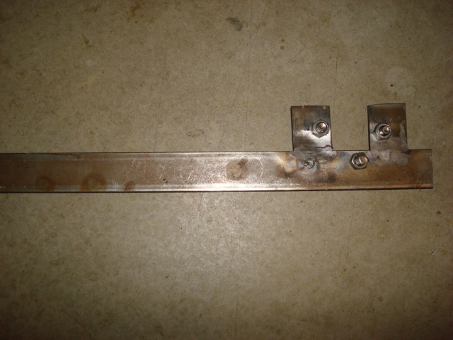

Some great ideas that sould work fine have been mentioned, I just made a tool out of some scrap metal.
Funny you should mention this because I was thinking of making something similar... Thanks!
