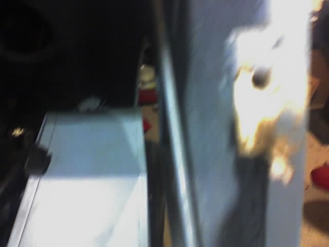

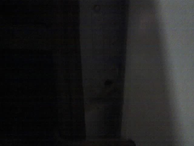

As promised here are two shady pictures, Pat

Guys, that is what it is, hmmm Nasa, two pins thru the posts and an extension on the bonnet lip. Lined up, with a pin.
Ohhh sorry for the pics!
Me wish I had some techno time to draw or a compu/cam for a better pic, but if you need some more info, I will gladly provide, maybe push BE outside for better pics, please let me know, but as I have told you this is custom for a camel food bonnet.

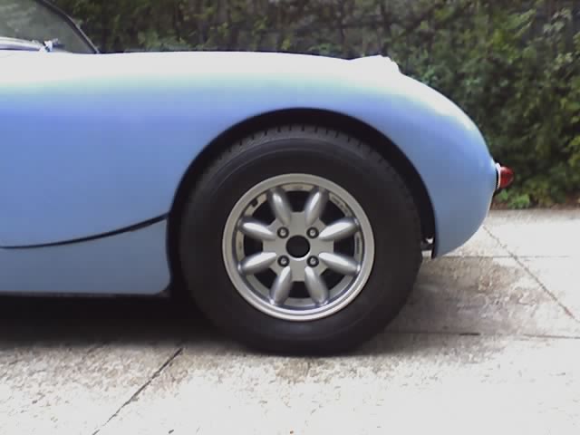

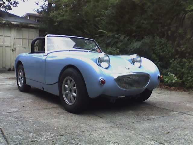

I don't currently have a good, clear picture (old camera /bcforum/images/%%GRAEMLIN_URL%%/grin.gif ), but mine seems to hold the hood alignment a little better, holding as it does!(forward adj.- all alignment of bonnet is done at the hinge! - IS a bit off in this old pic!)

Love to see, without any outside clasps, etc. and a fiber fit.
Hate! Hate! emm on the outside, BTW 91 HP to the FW here +/-/day and still on the pump gas, looks somewhat period I hope. Throws ya back two feet hehehe.
Pat
Edit, paint 15 years old
