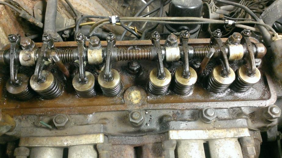

WP_20130308_001.jpgNot too bad. I powered the car and and when i pressed start the fuses blew. Ill have to chase that down. We tried rocking it in gear, but apparently it doesnt go into gear , and its impossible to push the clutch pedal down. So i'm taking the front apron off and putting it on my kwik lift. Where do i put the impact wrench if i want to see if itll turn over?
If it doesn't turn easily, not a good idea to force anything. From what I am reading, the tranny is stuck, the clutch is stuck, and the engine is too stuck to turn.
That may be a sign it's not going to be an easy one. My current TR2 project sat in a back yard for 24 years. The tranny was stuck, but the engine still turned over easily (by accident as I removed the flywheel bolts), without any oil in the cylinders at all. Yours sounds like it may be worse.
Please do not put an impact wrench on it. Use a long breaker bar, but do not force it if it is frozen.

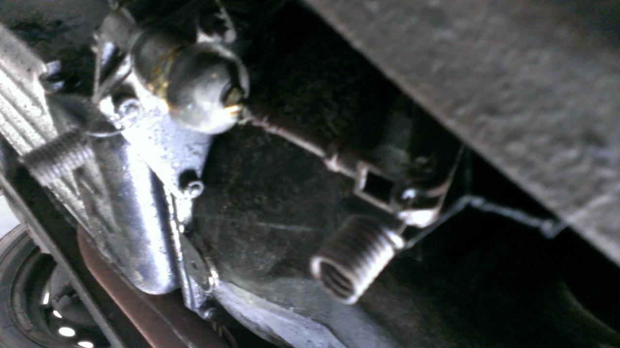

Wanted to see what was wrong with the clutch pedal and i found this. Perhaps that has to be replaced. Also trying to get the apron off all the nuts are spinning freelyin there little welded brackets so im trying to figure out how to solve that.
Yup, that slave will probably have to be replaced. Doesn't show well in your photo, but I think you will find some serious corrosion inside the boot. Pushrod looks like it is toast, too.

So I got the slave out and now the transmission engages. Tried pushing it with a friend, wouldn't budge. Working on that apron now.
