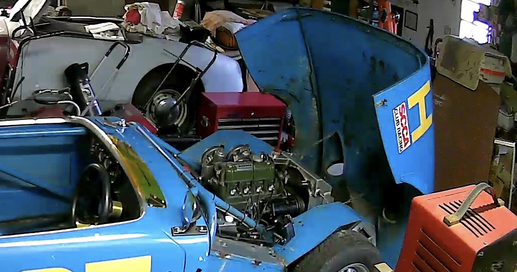

Hi Larry,
I have to disagree. My race Bugeye has a stock steel bonnet that is hinged to tilt forward. The access to the engine is way, way, WAY better with the bonnet hinged forward compared to my street Bugeye with it's cowl hinged steel bonnet. The bonnet on the race car is almost straight up and down vertically when opened and the only thing you can't easily get to is the front of the radiator.

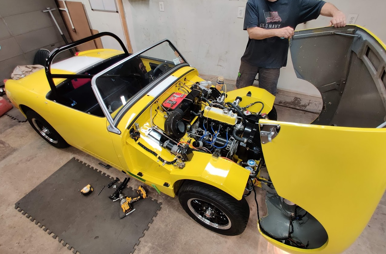

I did a pretty good job with the BE. Hood fully opens with loads of room to work on the engine. I can probably figure something out for the Midget to give really good access. Mind you not as good as the BE.

I would love to do the same thing with my Mark III Midget but it seems rather complicated which is why I am leaning towards just the bonnet and not the entire front end tilting. Does anyone have any tips, tricks, suggestions, procedures, etc. on what is involved, particularly from the standpoint of lengthening the wiring harness and how to keep it out of the way when the bonnet / fenders are closed. What kind of connector is recommended to be used so the bonnet / fenders can be removed if need be? How much does the harness need to be extended?
A 6 conductor GM Weatherpack Connector M/F Plug will work quite nicely. Comes with Pigtails if you pick the correct one and simply splice in the connector. I've also used a Trailer Harness Connection before.
