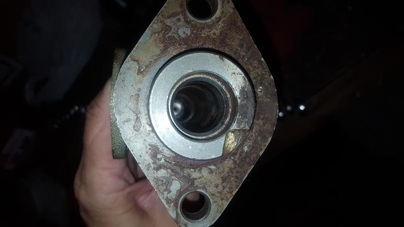

I posted a topic a short while back about my brake master cykinder speculating as to why it was leaky/empty. Well as pointed out I was totally off base about the brake servo sucking fluid out, so lets forget I ever said it.
I ordered a rebuild kit because I figured the BMC was only about 8 years old with limited hobby car mileage.
Being not overly bright this week I took the MC apart, rebuilt it, then cleaned and inspected the bores, little line of pitting or corrosion right at the bottom of the circle of the bore.
I have been a proponent of DOT 5 and will still use it, but turns out it is lighter than water, so it doesn't absorb it and water pools at the bottom of things, hence my problem, guess I need to flush it out more often.

Yes, kind of a Eureka moment for me too, though I wish I could have figured this out without sacrificing my master cylinder. You can see the pitting as the bright spots in the bottom of the bore.
Not sure why the website rotated the picture 90 degrees and repeated it, but you can see the corossion on the bottom of the bore, to the right of the picture as displayed. It is also longer along the bore than appears in the picture, but the angle compresses the length, about 3/4 of of an inch along the bottom of the bore.

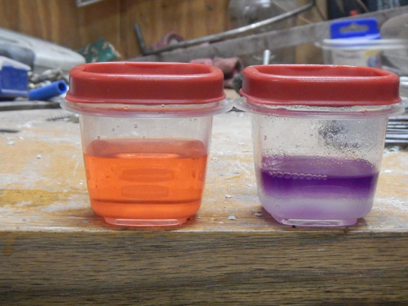

Just mixed some water with both DOT 5 (Purple colour) and DOT 3 (Red Colour).
The DOT 5 immediately separated and floated on the water.
So I think that I will be using DOT 3 or 4 as I live in a humid area.
