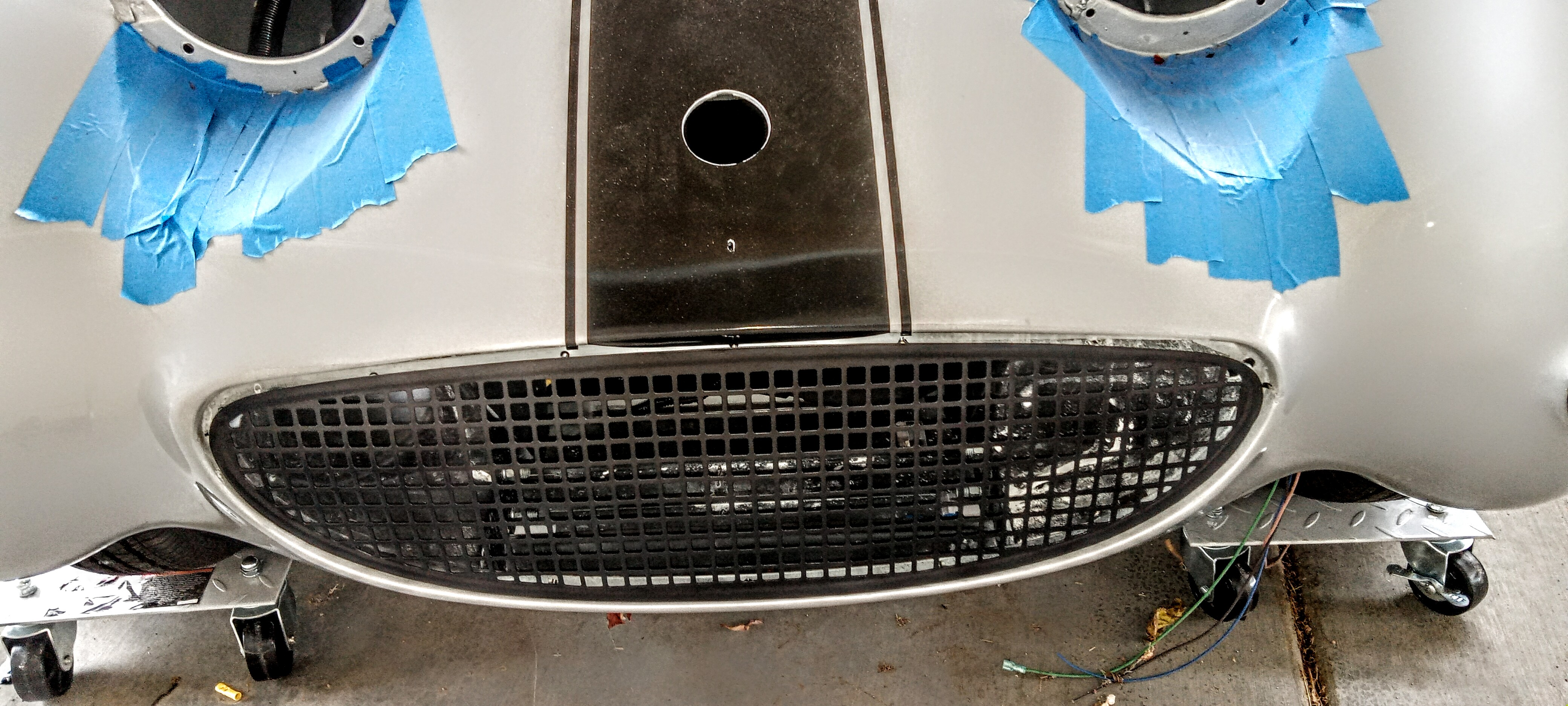

I received the cut down grill from Bugeye Guys. It comes powder coated with 1/8 inch mounting studs that take push on speed nuts. I threaded the studs and will use nuts and lock washers. The grill will get coated a satin titanium or medium grey to match the other bright work. The grill stands a little proud because of the nuts and washers. Also, the black stripes will be replaced with titanium or medium grey.
