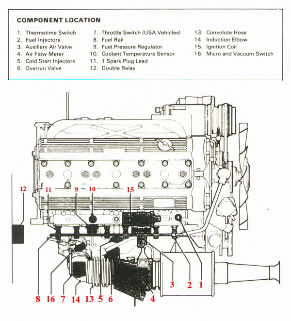

<div class="ubbcode-block"><div class="ubbcode-header">Quote:]But: how do you know that the AFM needs replacing?[/QUOTE]
I really don't....the top being unsealed bothers me & after a major tuneup & about 300 miles, it occassionally skips a beat or "speeds up" slightly....those could be symptoms of injectors still not completely cleaned (the car sat for some time before I got it)...I'm adding Lucas for gas to the tanks & using 93-octane for a few tanks to clean things up.
just seal it back.
the engine "speeding up" the revs up and down is the classic symptom of a sticking/dirty Auxiliary Air Valve, not the AFM.
Another reason is not-seated or cracked "convolute" hoses, the large diameter hoses from the AFM back to the 90 degree aluminum elbow at the intake butterfly. Make sure the hose sections are well seated and not cracked. It's the simple silly stuff that causes the symptoms.
