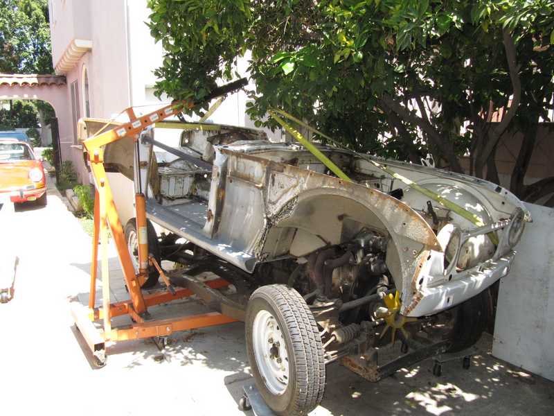

I just pulled the body off the frame. I replaced the floors and rockers with the body in place, to be sure everything stayed in alignment. But somehow, it just didn't seem like I was making progress; there was no dramatic, immediately visible change. Now there is.
I made the cart so I could access both the underside and topside easily. I'm glad that I got a set of good casters; I can move it around effortlessly.
The chassis is now in the garage; I've removed the engine and transmission. The main job now is cleaning off a half-century of crud.

Great work!, question, did you install/weld the rockers in first and then the floors after; or did you assemble/weld the floors and rocker panels first and then offer them up as a unit to the car? Which way works the best?

I think you have to do the floors first, because the inner rocker is actually part of the floor. If you did the rocker first, you'd have to weld the lower edge to a piece of material that you would later remove, and that, of course, doesn't make much sense.
