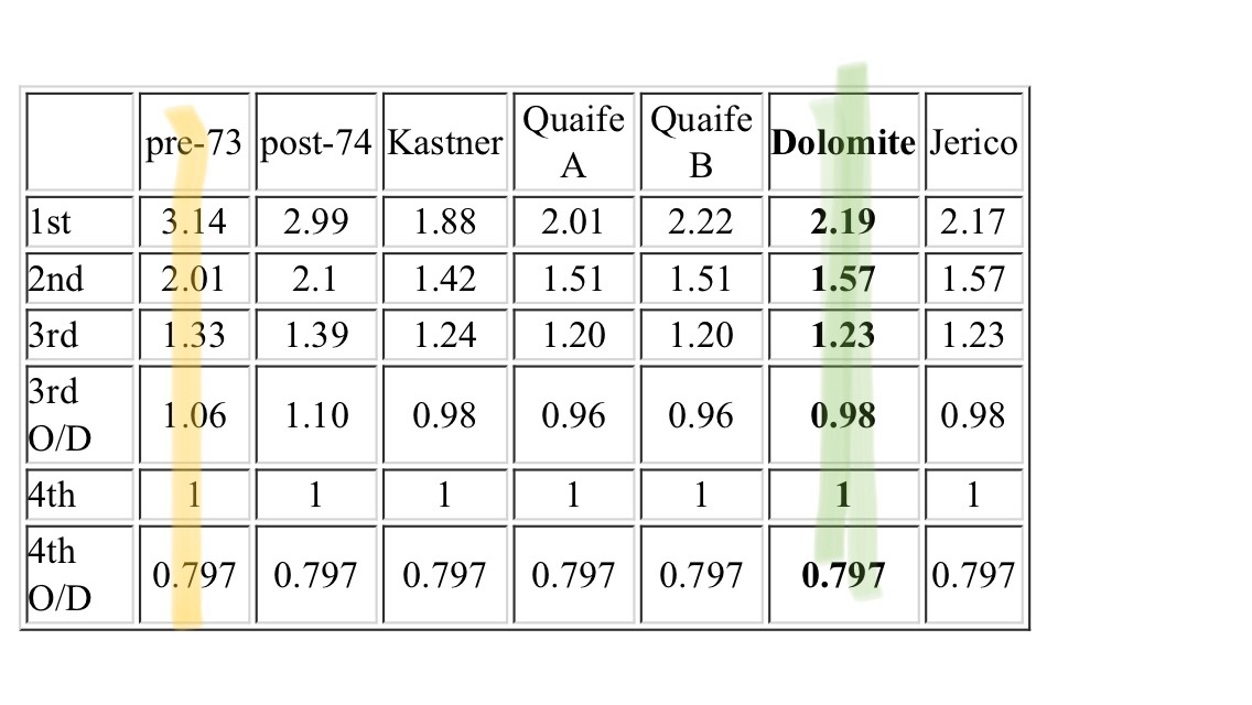

I have an early 6 box in my 3a and 1st is 3.14

No, but the gap in TR6 gear ratio to 2nd is less. The TR3 box should be quicker off the line but the rpm will drop more when shifting to 2nd. The TR3 box has a non synchromesh 1st while the TR6 has sycho's on all gears, this is probably the reason most people would make the swap.
So the TR6 gear box in a TR3 would make the car a bit faster from a standing start than the stock TR3 box, correct?
Yes my TR3a with an early 6 box will accelerate 0-64ft in 2.35 seconds on the flat. Modern single seaters with launch control do it in about 2.
The hills are a little slower.
