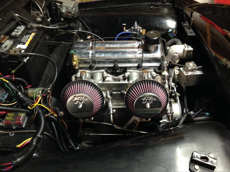

Fwiw: I replaced the black domed "rock catchers" with these K&N air filters #56-9327
I purchased from Amazon.
they were about $70. Bucks each, but reusable. they offer a lot of air intake surface area.
Fit well, and the conical shape clears everything important on a 3.
FWIW, I replaced my "rock catchers" many years ago with the K&N 56-1400; they're the shape of large tuna cans. The front just barely kisses the inner fender well; otherwise they fit the SUs perfectly. I like Guy's tapered filters better, but I don't think they were available at the time.
The 1400s are even more expensive than the 9327s, though ISTR I paid half the current rate...
