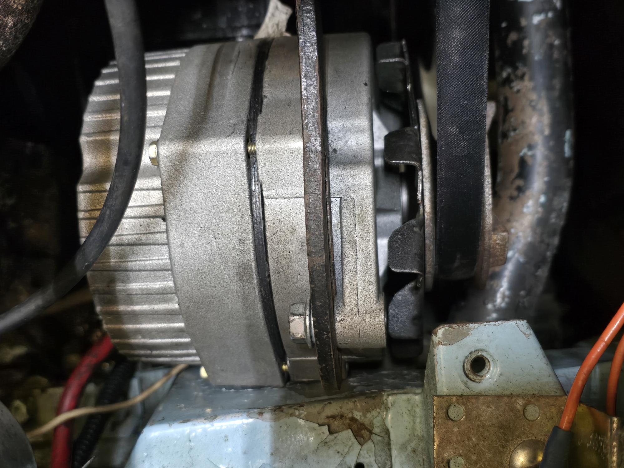

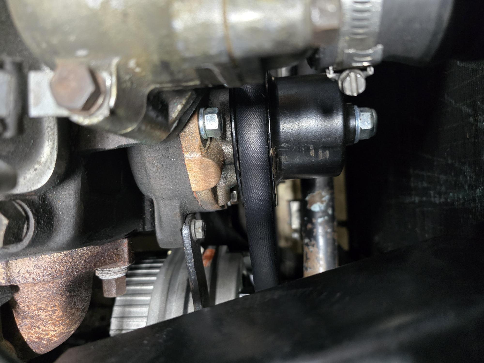

Working on a recently acquired 1961 Tr3A. GM Delco Alternator required rebuild. The belt received on the car was a 5L380. I found it impossible to reinstall that belt, simply not enough length. That may be why the PO replaced the water pump just before sale.
Tried the Gates 28386 which was suggested elsewhere, and found it too wide for the original pulleys.

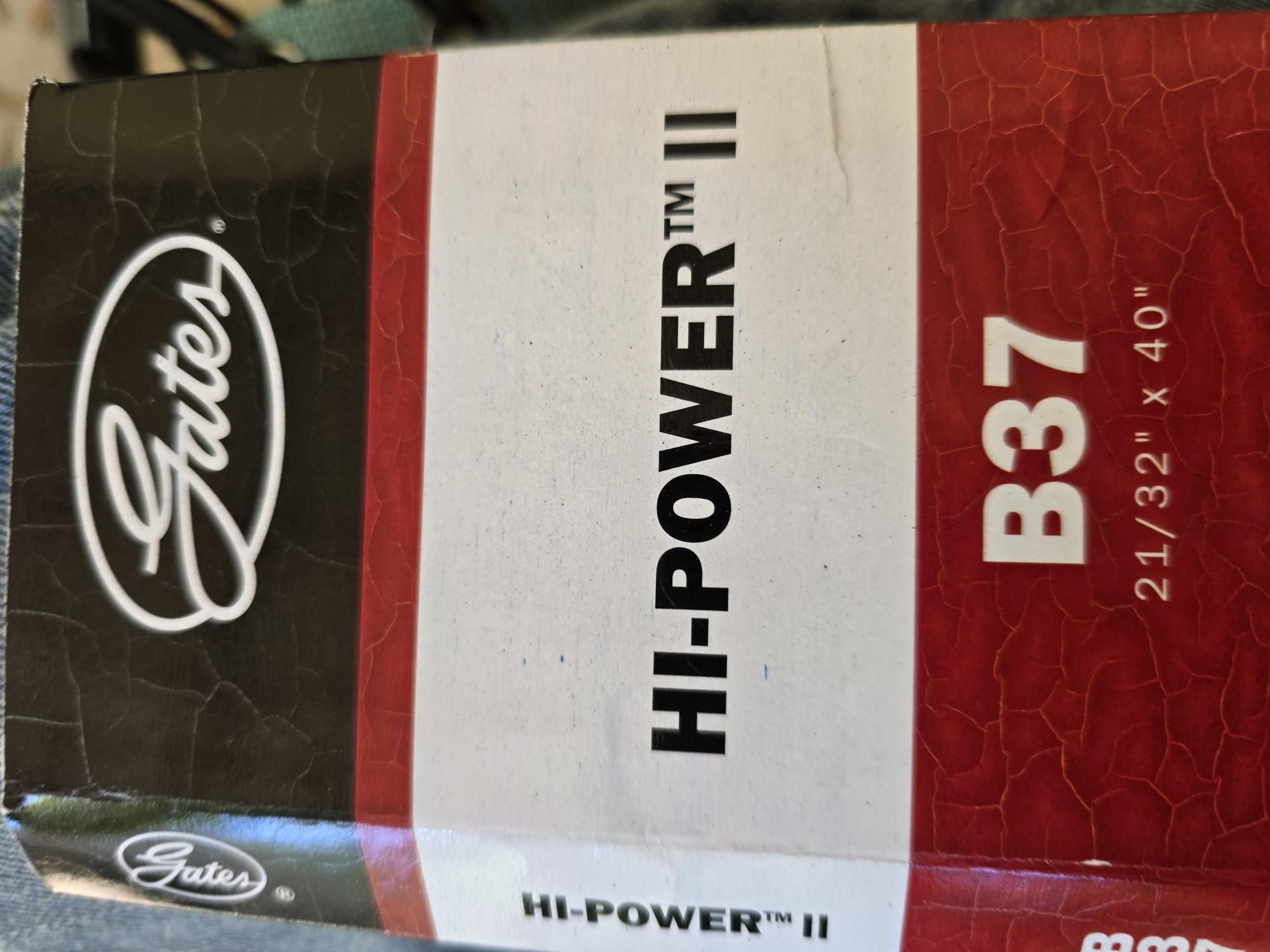

Discovered the Gates B37, which is the correct 21/32 width, and 40 inches long. Simple to install, but takes the alternator against the fender bracket to get the correct slack. 52 miles later, looks good.

As you can see in the pics, the Gates B37 is an exact width fit for my Delco alternator. The alternator is rotated as far from the engine block as it will go, to accommodate the extra length. Posted this to help others who may have difficulty installing the belt. B37 is 21/32 x 40.
