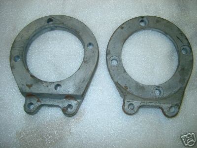

I was reading the article “ Healey’s Six-Slug Slugger” in the Austin Healey Magazine and one thing caught my eye. Towards the end they mention converting to full disc brakes, noting kit #H8462 for the rear. Anyone know anything about this kit? Was it from the factory? The conversions I’ve seen photos of, there was grinding of the axle to get the caliper bracket to fit. I’m wondering if H8462 was a direct bolt-on. I’m curious if the parts list mentions it and what components used were(note to self: I really need to get one of those lists).
Sorry I should have added in response to Pattons question, that 40 (or 50) 100-Sixs were specially produced with these disc brakes already fitted. This was to homolgate them for racing. This is confirmed from several different sources. Healey author Bill Piggot owned one of these cars which were manufactured at the end of 1957 but its unclear whether they had any special numbers given to them. The option package was available throughout the 100-Sixs life
gregw, two or three months ago a set of a.h. rear disk brake brackets were for sale on ebay reputed to have been removed from a factory works car,they did give part numbers but i didnt write em down. just checked ebay and they are no longer listed. /ubbthreads/images/graemlins/savewave.gif

I don’t plan on converting to rear discs until I have a chance to run the car through some fun canyons around the area and there is still much to do before that happens. I may be completely happy with what is on the car at present (PBR booster, SS braided lines, stock rebuilt everything else). I was more curious if there were any differences between the original MM caliper mount and the modern offerings. It may be a long time before I actually see an original four disc Healey since so few were made. But I will keep my eyes peeled.
Randy,
I remember those. Problem with them is they are the pattern for dunlop calipers (remove to replace pads like a 100S). The seller noted he had no idea where one would find those Hen's teeth. /ubbthreads/images/graemlins/ooo.gif
BTW there were 2 sets in the classifieds of this BBS for sale a few months back. 900 per set.
