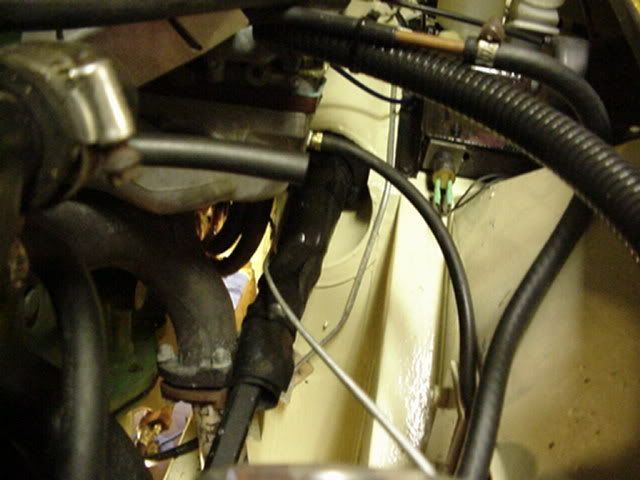

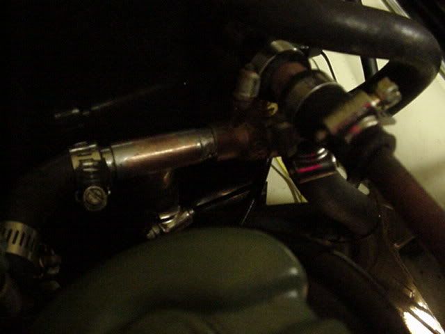

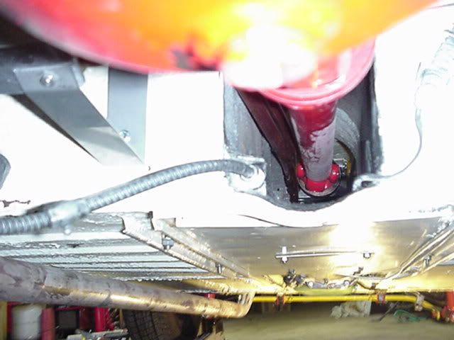

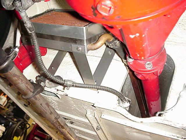

I put a brand new pump on it when I rebuild the motor. I never realized there was a difference in them. Does anyone have any info on this deal about too much circulation and running hot? I know that my pully is not stock the stock pulley was plastic and broke years ago and I am not sure if the replacement is the same size. I kept on with the project. The heater core I am using is out of a subaru (because I have one laying around) and I also used the heater control valve out of the subaru, so I can cut this extra cooling off or on or shut off if I should develope a leak down there. I bought the copper line and have them bent and installed and the valve too. Started making a frame for the heater core and ran out of energy yesterday. Hopefully get it put in this evening and then Tuesday hook up all the heater hose Tees and test it out. I think it will help. I have had sevral cars the would overheat and cutting the heater on would act as an extra radiator and help cool it back down. This core is totally open so there should be plenty of air flow under there at speed, more than the heater fan I hope, plus 8 feet of copper line through the tunnel which should have air flowing through it as well.
Everything installed underneath. Had to make a few parts and took some time. Got to hook hoses up tomorrow under the hood and test it out. Hopefully this with help at least till fall when I take it off the road and put my Sportage back on the insurance. Then in the winter I will work on it. Already got an electric fan coming that I bought off of Ebay. Will probably install that one right away as time allows.

Well, its done. Tested it out but it is only 71 degrees outside and I ran it hard and could not get it even up to the N mark. the hotest it got was when I shut it off in the basement. Still just over the N. Time will tell. Here are some pics of the final thing. I could put my hand on it and feel it was scalding hot and at speed must have been removing a lot of heat. I could see the needle drop pretty quick after pulling away from a light.
Looks like nice work.
