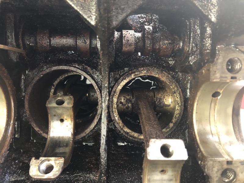

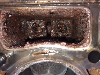

This 1960 TR3 has been sitting 40 years. As you can see the accumulation of crud and rust has made disassemble difficult.
Does anyone have any suggestions for “loosening” up this crud to make getting the cam, pistons and sleeves out any easier??
PB Blaster and a torch only go so far at getting this done, and as a local machine shop has told me, the EPA has banned the “good stuff” that would have made this job easier.
Thanks for any suggestions!

Hey Joe...making headway!
Most guys use a wood block and a BFH to knock the sleeves out. Occasionally you'll get a stubborn one, but usually they knock out pretty easily. The pistons can stay in if they are stuck in the bores.

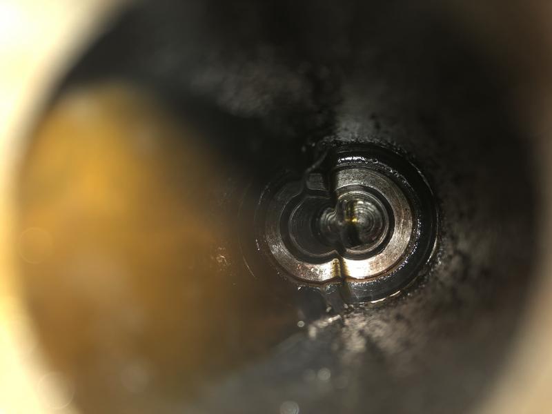

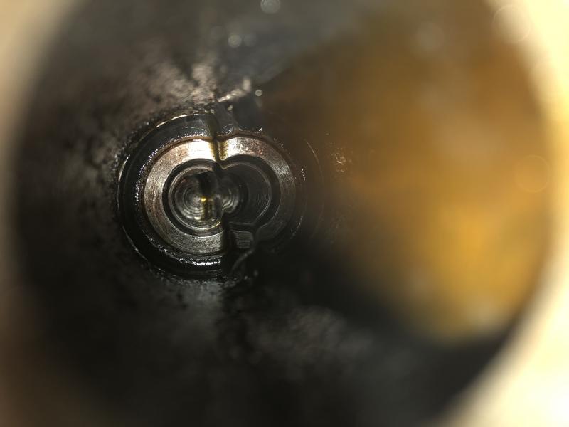

Those lifters are impressive! They may be tough. I would keep soaking and trying to pull them from the top with lock ring pliers...until it's apparent that is not going to work. After that we may have to leverage the bottoms against the cam lobes. Of course that will write off the cam, so it'll have to be a last resort. First using the sprocket and a long cheater to rock the cam and raise the lifters...and finally actually using a screw driver between the cam and lifters. Once they are up about .28", then the cam can be removed and you can easily tap them all the rest of the way out.

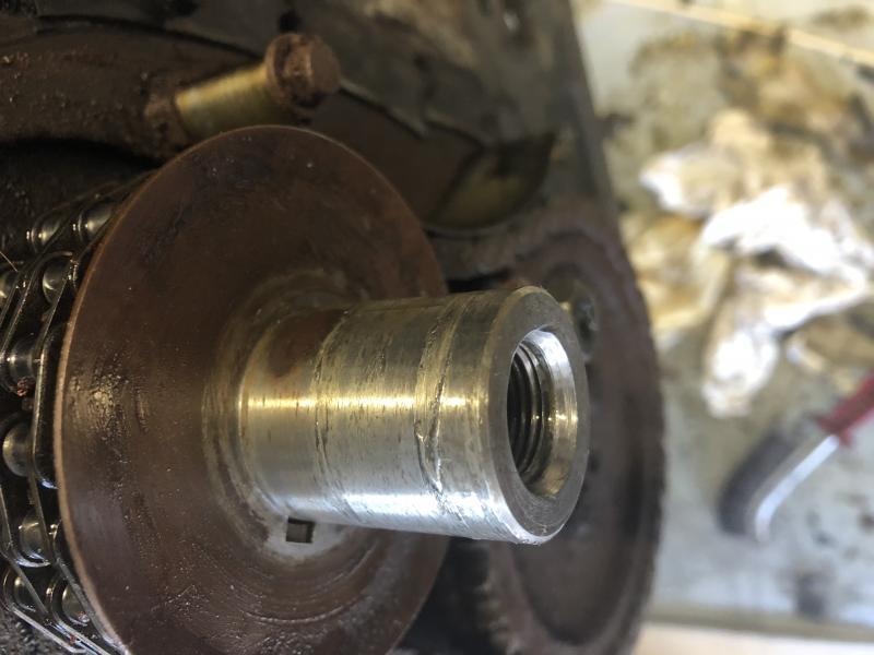

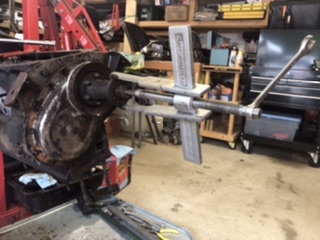

Any luck with the front crank hub? I assume so, since the crank is out. How did you finally pull it?

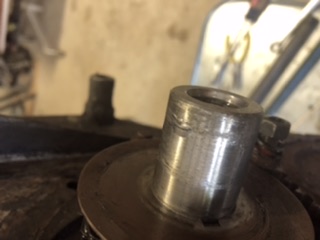

Hey John,
Yes, finally got the crank pulley off. Those 2 “extra” pictures on my 1st post were of the pulley soaking in PB Blaster to be followed by my big dog hub puller. It was then that I discovered WHY it was so difficult to get off. It appears that the Woodruff key SLIPPED, marring the crank.
I guessing that’s why it was “parked” 40 years ago. I hope the crank is still usable. I plan to take the block and crank to a machine shop when
I get everything apart.
I’ll keep you posted.
Joe
.80DF1860-9566-40F5-9A15-512283027798.jpeg92B5FF67-E49A-454B-A550-88CE4496E1BD.jpgA05F9938-A94E-47AE-B886-5AE4BB48274C.jpeg
Ouch! That key hasn't been much of an issue. I would think the main crank bolt must have been loose.

Didn't read the article as there was no google back then, but I've been using 50/50 diesel and ATF for decades, works quite well. I'm sure either is good. Diesel is a great degreaser by itself.

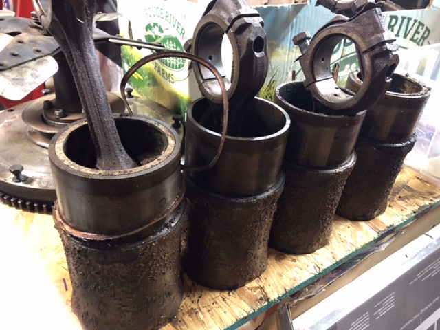

After depleting AutoZone of their entire stock of PB Blaster, “I’m kidding” I left 2 cans on the shelf ��, I broke out Ol Yeller!
As suggested by Yoda John, I got out my BFH and went to town.
Pistons and sleeves came out as a unit, I’ll be in the market for a new kit from Moss.
The lifters we’re solidly rusted in making cam removal quite difficult, but Ol Yeller came thru again. Yeah I’ll be needing lifters AND a cam too.
But the block is finally read to dip. Progress I tell ya!!
Pictures from above post.
