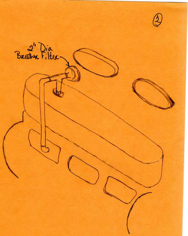

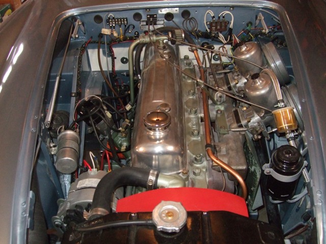

Maarten, Remove the hose that goes from the valve cover vent to the rear carb. Put a 2" diameter filter on the "T" fitting of your valve cover vent as I show in the picture. Even if you don't want to keep running it this way this is a good test. With the filter installed drive your car for awhile. If the filter never gets saturated with oil then you don't have an over oiling problem. I have been running my BJ7 for more than 10 years with the hose removed from the rear carb and the 2" filter installed at the valve cover "T". I can cup that filter with my hand at anytime and my hand will stay oil free. I change it once a year. This method goes along way to help keep your rear spark plugs clean.
